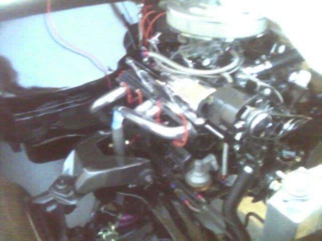

oh heres my 1978 frame off resto chevy monte carlo with a 383 stroker blueprinted and balanced

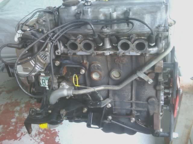

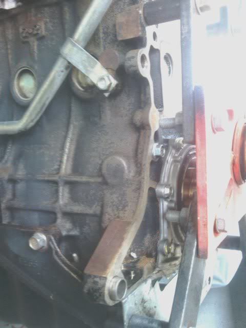

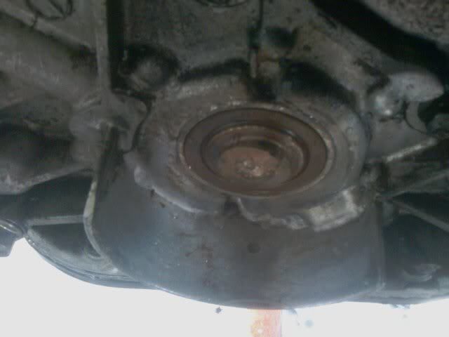

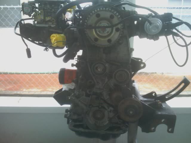

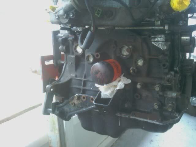

ok so i got my motor out and plugged it all up pressured cleaned the motor came out really good (better to work on a clean engine then a grease ball) i have a few questions to ask
1. talked to a machine shop and he said he wants to see the head to see if i bent any valves does this happen when the crank snout breaks off?? is there anyway to see if the valves are bent by rotating the camshaft or something?
heres some pictures of what im working with (its a damn shame too i just installed a indash and did the mod to move it up under the a/c vents still have to fill and mold the plastic around the housing also threw in the grant woodgrain <img src="{SMILIES_PATH}/icon_biggrin.gif" alt=":D" title="Very Happy" /><!-- s:D --> )
