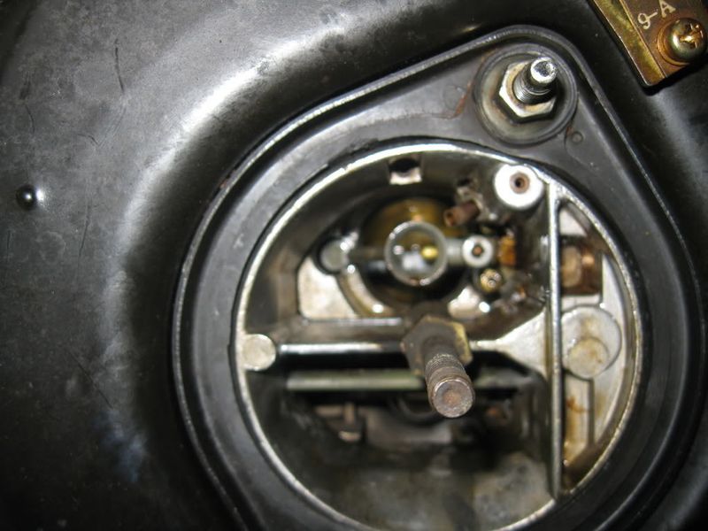

Well. it started fine all day.. until now. the wife hasn't rode in it since it has been lowered.. and wanted to ride into it. started up fine heading to mcdonalds. only maybe 1/2 mile. stop a light it starts chugging... it was alittle low on gas. i stop and dropped 7$ into it since i don't drive it much. got to mcdonalds had to pump the accelerator and hold it fully to the floor to even start.. its misses and now when it stay idle well trying it sorta smokes. and smells like fuel. i have upload a picture there is fuel sitting in the cracks. and two video's it would be great to figure this out. oh fyi. i gotz sexy feet

stock carb= accelerator pump most likely. I'd runs some sea foam through the carb and get some new plugs and wires if you haven't already. and inspect the cap and rotor. pull some vacum lines and see if they are full of fuel good indicator its the carb.

That's EXACTLY how mine runs and idles all the time. Low, lumpy idle with the motor vibrating like mad. Does the whole truck shake at idle? I get a gassy smell with mine, but no smoke. I only have the cat on the exhaust manifold and stock carb.
Do you find it hesitates from a stop or sometimes while just cruising down the road?
