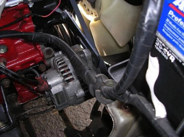

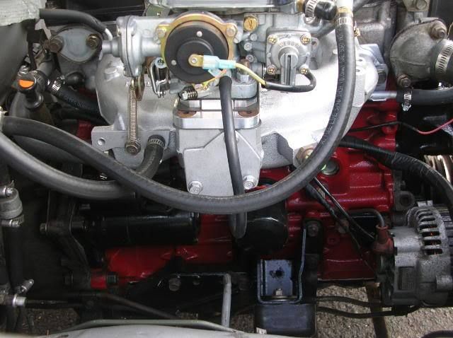

hawaiian

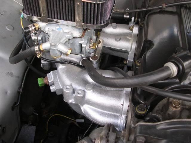

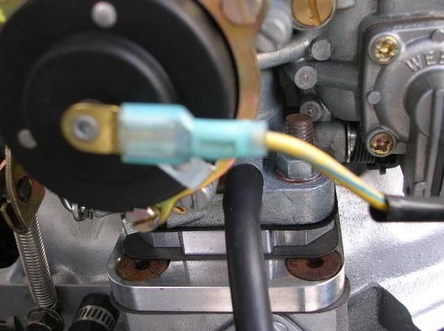

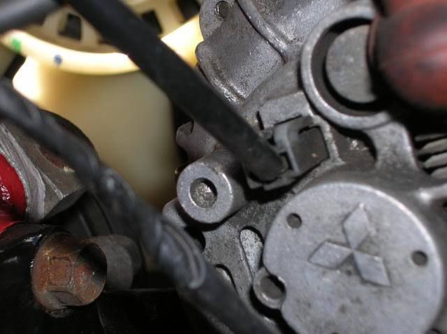

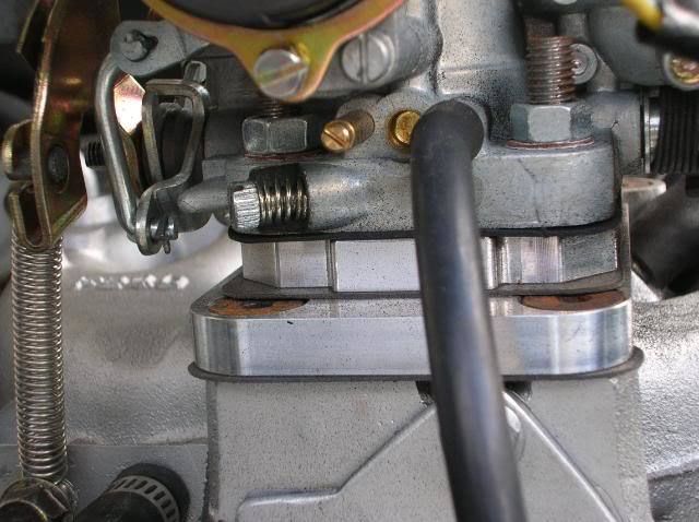

Choke plugs to the back of the alternator. I cut mine off the stock carb cuz it was soldered and just replaced it with a new connector. Vac for the dizzy should plug into the vac port on the carb, the one on the right. The harness from the computer can be completely removed. It does not go around the engine bay. You need to unwrap just a small section to follow the harness. The only wires left should be for the wiper motor. I removed everything. Comp and harness, egr, evap canister, and pluged all vac ports except for the one that goes to the brake booster and one for the dizzy. I'll see if I can get some pics.
hawaiian
Vac hose to Distributor
Choke wire to alternator
Choke wire connection behind alternator

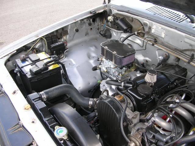

EGR blocked off
Vac ports plugged. I welded mine but you can just uses caps.

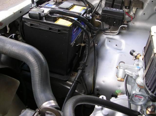

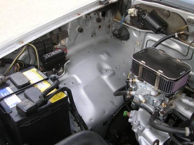

Wires from battery to starter , alt , and under hood fuse block
wires and vac lines gone
lowridenmazda
thanks those pics were great. what are those relays and such for that you left on the inner fender well. i dont have any of that left. there is absolutely no fender i just got to find a place to mount the fuse block.
hawaiian
I wasnt sure what those were for so I left them in. Thought they could be for the headlights or ac relay so I didnt bother with them. If someone knows what they are that would be great so I can yank them out if its not needed.
