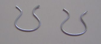

The window cranks have a small metal clip that holds them on, like this
They shouldn't need heated up.
badchicn (rick)'s avatar
badchicn (rick)
yeah take a rag and slide it back and forth between the door handle and the door panel. The clip will get caught in the rag, popping the handle loose.
