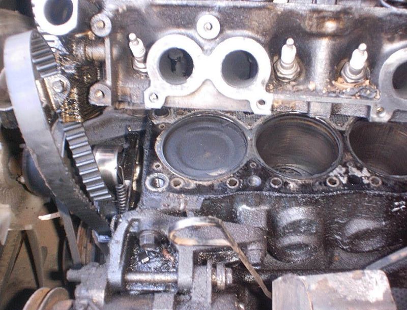

Well pictures are being uploaded to imageshack right now, its being a stubborn lil bitch so its taking a bit :/ just like everything today.
So it turns out that the Magnum engine that I have is a F8 1.8L, standard looking 3 valve B series pistons, 9.0:1 compression ratio, same 86mm bore but destroked to 77mm. Which is less than thrilling to me, if it was V-8 I would be thrilled with a 3 inch stroke, but on an anemic mazda 4 banger :/

Thanks for posting your information.
I think after you put your engine back together and redo a compression test, you are going to find that your compression has dropped to 8.6:1, due to removal of carbon buildup.
I also think you have proved independantly what I have stated repeatedly:
The MAGNUM motor is a destroked FE.
1.8
The only reason it got the MAGNUM label is due to the bigger bore and pistons than the 1.6 it evolved from.

Here's yer pic.
The problem with a myth / rumour is that ignorance keeps it alive.
