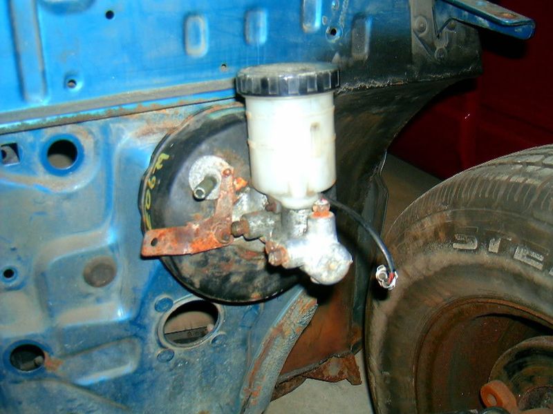

Hey guy,s it been a while since I posted. I've run into a small snag I looking for a smaller brake booster and was wondering what you guys are using. I will post some pic's of my progress to night

bodied b2600zx (josh)
I want to know this as well. . . I got one off of a 95 geo which isn't as small as 94 and older but is small enough. . But the rod that connects to the pedal is like 3-4 inches shorter? ? ? ? What am I supposed to do about that? And ya, I was pretty sure you jus use the mazda master cylinder right?

solow93 (ryan)
I would think yo ucould just extend the arm but not sure

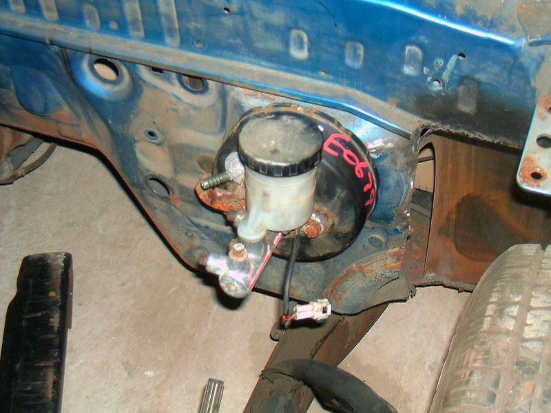

V
v8mazda4ever

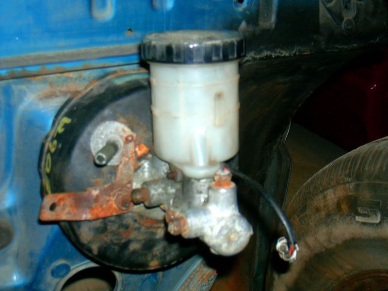

here is the booster installed. yes it is out of a 94 geo metro. You can use your mastercylinder or the one that it comes with and yes just extend the arm.

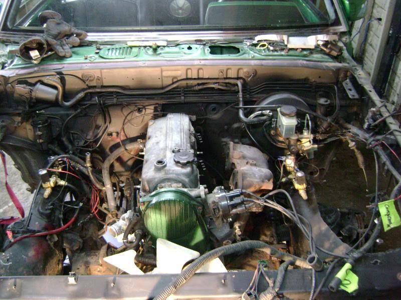

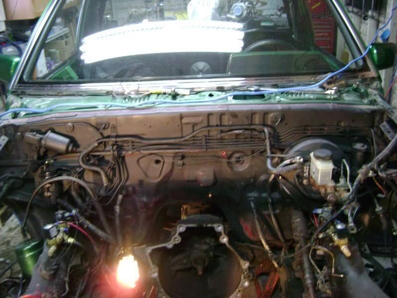

solow93 (ryan)

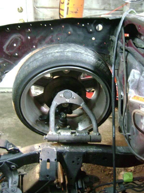

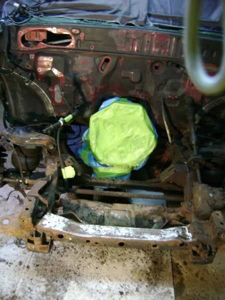

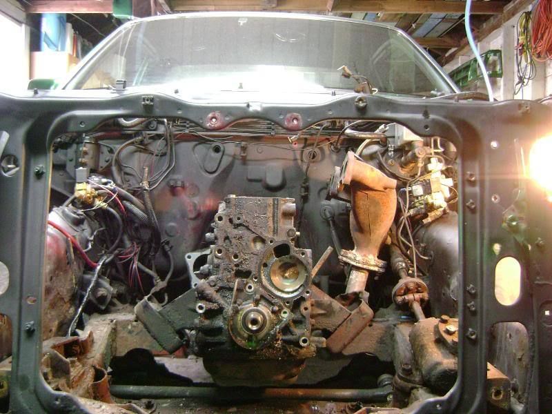

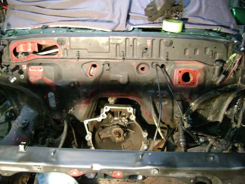

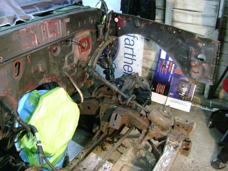

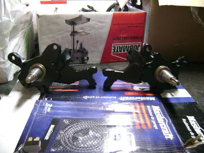

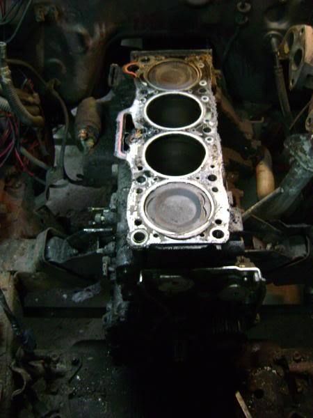

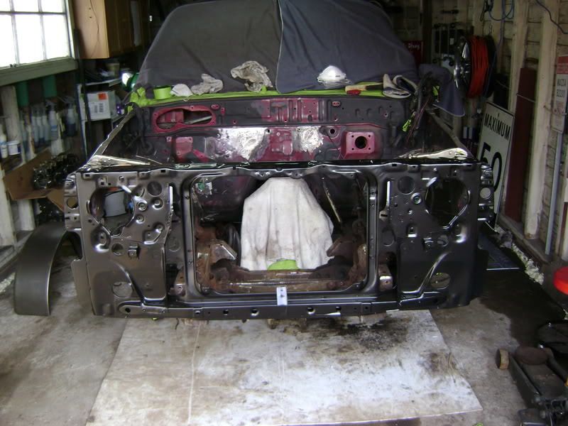

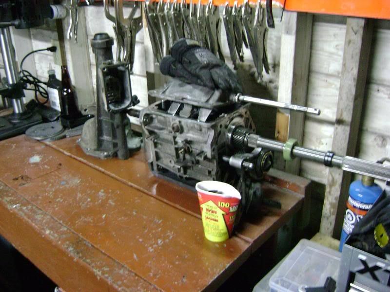

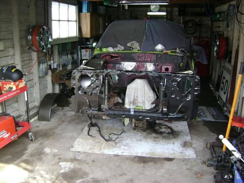

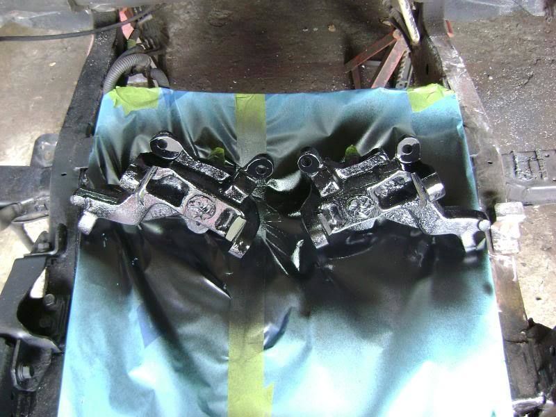

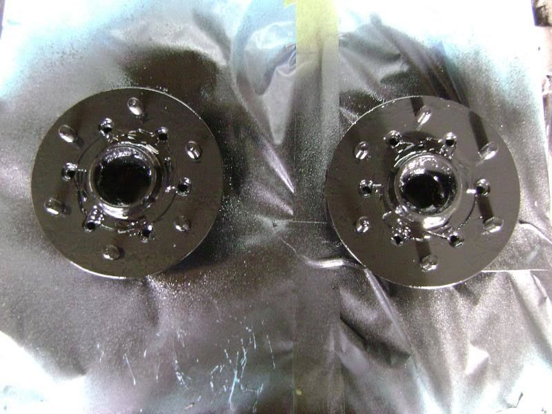

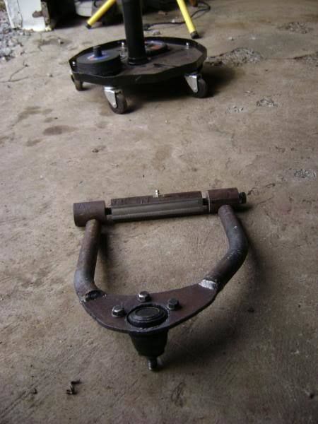

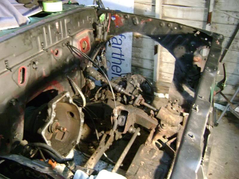

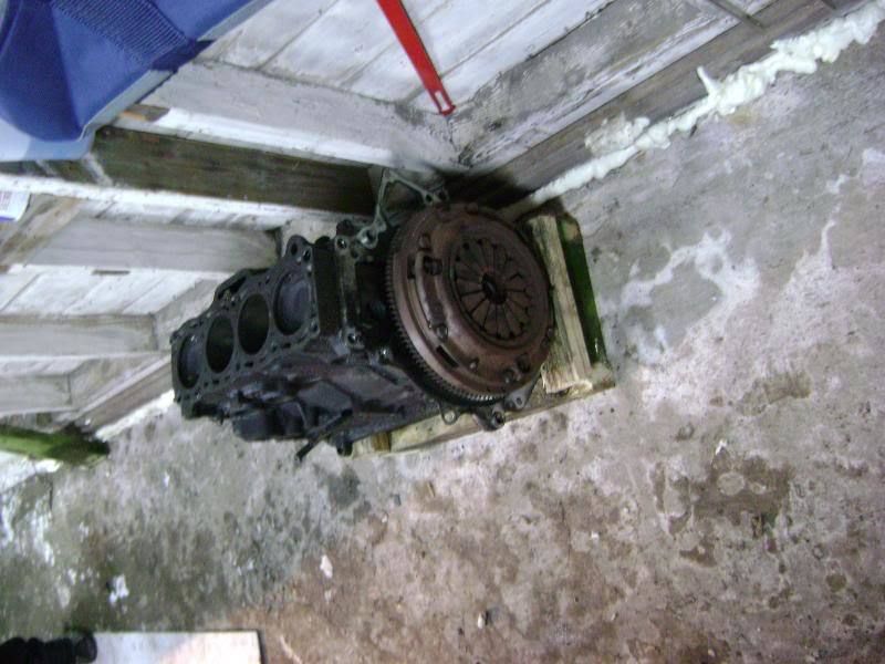

Ok here are some pic's.Thanks for all the info guys. Hey Lance what are you doing with the clutch master?
maz2low
You need to extend the rod if I remember correctly , I will check on my truck in the morning . I did this swap like 5yrs ago and slowly it traveled .
