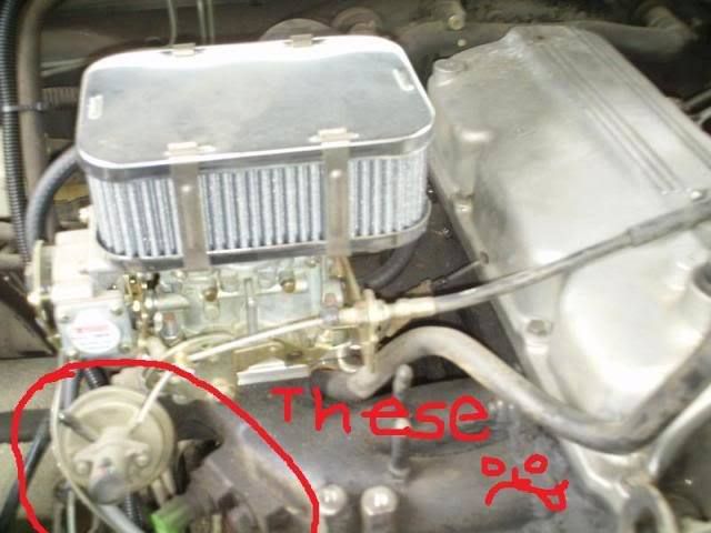

the ones I am talking about are the sensor on the intake mainfold (it is a green colored one on my truck) and the one below the carb towards the pass. side inner fender. I will try to find a pic and circle them.

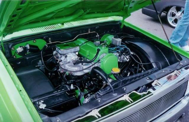

in this one he doesnt have the one I am talking about, so I am guessing I can loose that.

yeah you dont the egr valve just capp it off ,if thats what your talking about tre
