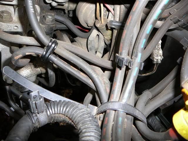

were is the knock sensor ?
here are the pics dunno if they will help or not
its puoring down rain or i would have gonne some more
