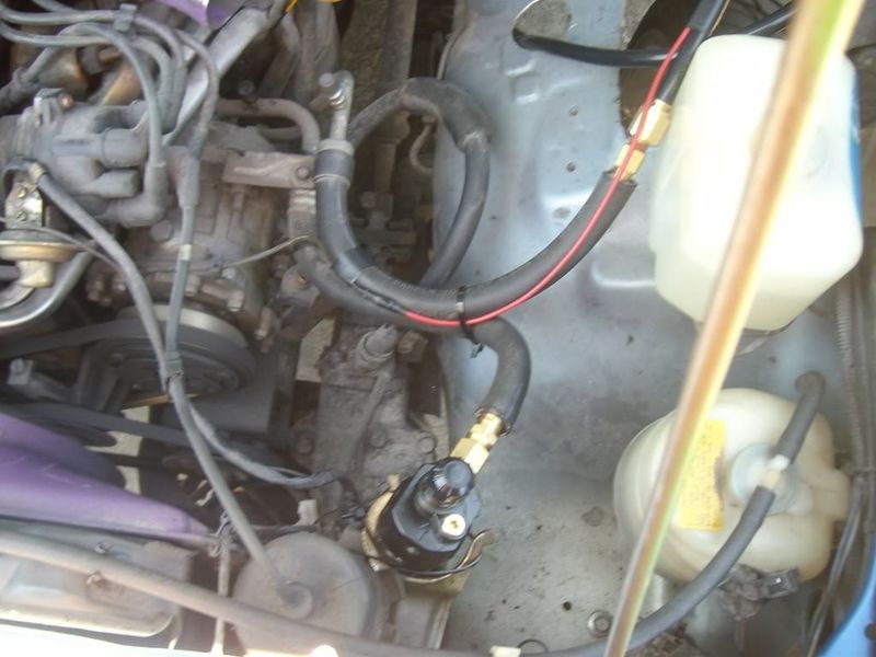

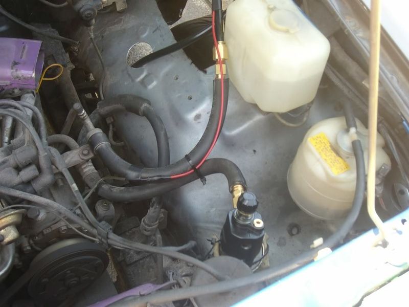

oiler

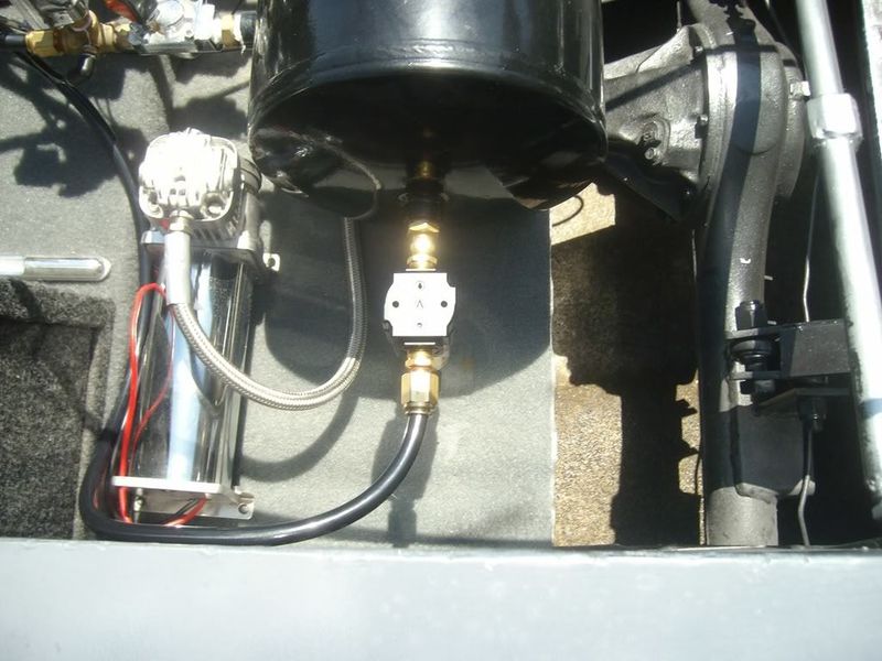

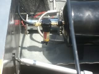

Filter

so what kind of oil are you using setup looks good
cl (chris)'s avatar
cl (chris)
5W30 seems to flow thru the system nicely
looks good

you going to put a hose clamp on that barb fitting? if not it will eventually come out of there..... also what kinda of pressure you getting?
cl (chris)'s avatar
cl (chris)
90-B22Dawg [Andrew] I will. I only run 150 PSI max so it fills from zero to 150 PSI in around a minute at 1500 rpm heck of alot quicker than my viair compressors.
