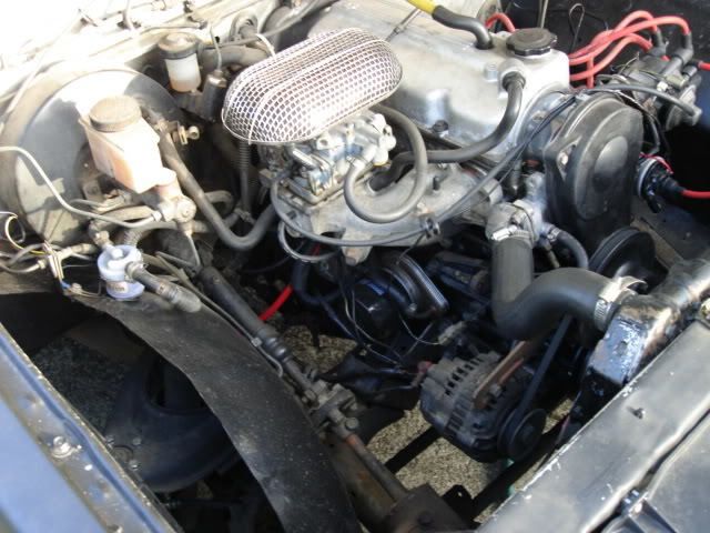

na, just go with a weber, easy to fit and makes a huge difference to appearance and power

Looks good! I need to take all that shit off mine. I got a Weber on it, but a lot of the other stuff is still there.

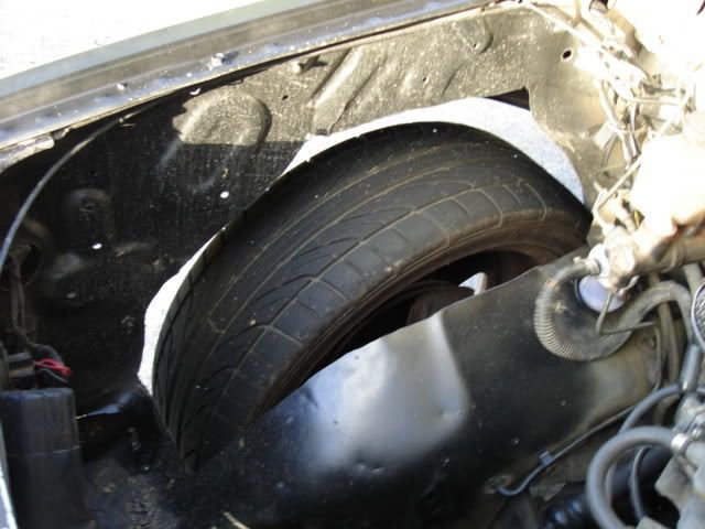

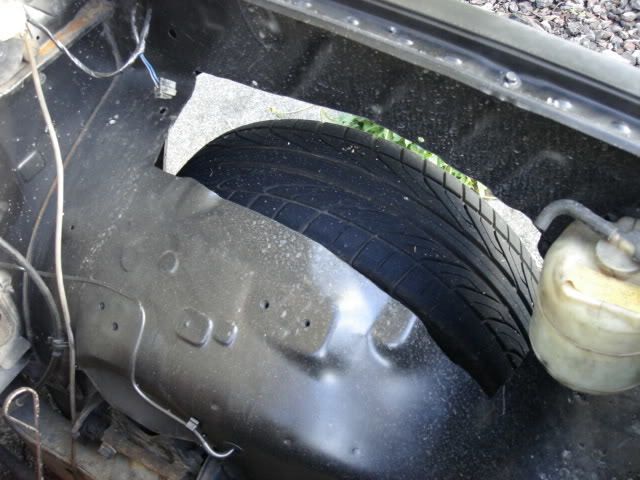

heres mine. hidden all wires behind gaurds was a mission tho, and took me bout 3 hours to get car running again...lol... had a few wires crossed
long roof's avatar
long roof
How come you didn't cut the whole inner fender out?
lvnlo
just did wat i needed to until i bagit and then i will put new inner wheel wells in,
long roof's avatar
long roof
Sounds good!

will a weber work with air conditioning?
90-b22dawg [andrew]'s avatar
90-b22dawg [andrew]
sure.... the a/c has nothing to do with the carb!! now heres my question.... how do i find out if i have a manual pump or an electric pump? also when installing the weber do i need a pressure regulator? and what to do with the lines that go to the exhaust manifold?
twitch
well if u have a mechanical fuel pump u should see it off to the left side of ur engine. it will be between the carb and the V.C ( it operates off the head) near the firewall. And from what ive read the weber operates on 3lbs of fuel press. i think from factory there set at 5 or 6, so yes u would need a regulator......not 100% sure on that though......
