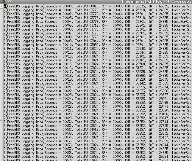

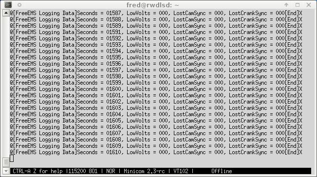

Minor update :
Human readable serial logging is working as of this morning. I'll tidy it up and add a bunch more variables before doing a release later today.

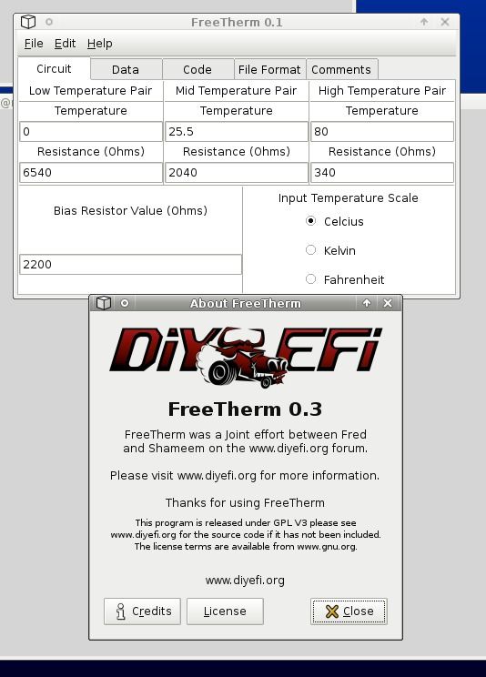

Introducing FreeTherm a new little utility that does a similar thing to easytherm :
C# + mono = "up yours" to M$. (microsoft)
Result :
Real temperatures in the ECU :-)
Too easy.
(in degrees K * 100, so divide by 100 and subtract 273 for deg C, you are on your own for deg F)

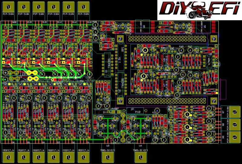

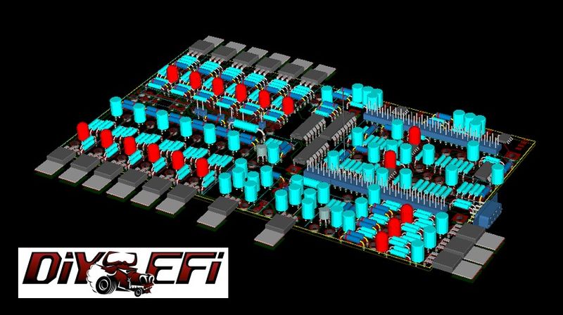

In the mean time a couple of clever blokes called Jared and Dave have been hard at work designing some hardware for us :
Those are just drafts, but it is coming along pretty nicely. So nicely in fact that they are well ahead of me. By the time I'm ready to run an engine, the hardware will be chrome plated and capable of running a small city

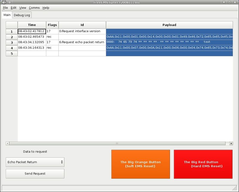

I'll give you a screen shot of the big red button because that is fairly cool in a childish sort of way :
One guy in Wellington NZ and one in South Carolina are working on that, and I'm working on trying to make the EMS side of the comms deal ROCK solid. Currently it's pretty good, but I'm not done yet!
I hope to finalise more of the comms stuff and do another release in a few weeks or less such that those guys can focus on making a nice GUI for it while I work on the guts that will actually run the engine. Mean while the hardware guys will be working on their share, and hopefully we'll all come to a climax at exactly the same time producing a wonderful system that actually works TM

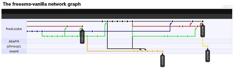

In other news, the network graph on github is quite interesting at the moment :
