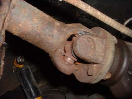

There's an example of a munched UJ
You'll know it when you see/hear/feel it. Let us know how it goes!
