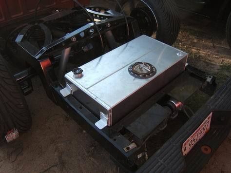

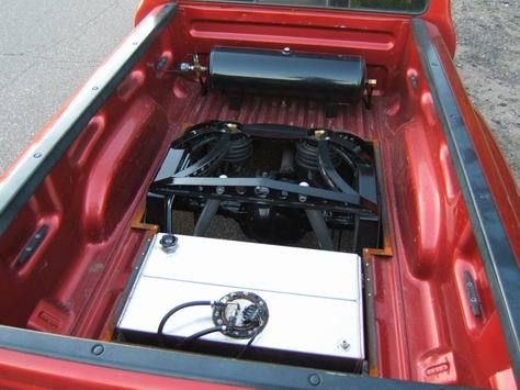

21 gal tank aluminum tank. custom made to use the stock fuel pump and sender.
