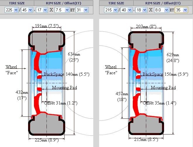

i am looking at 18x8 wheels with a 35 offset
according to the calculator thats 5.87578616352 inches

found this info on a Ebay ad, the 31mm on calculator comes out to 5.71855345912
according to this they will actually fit better...correct?

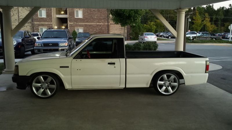

My truck is running stock 18x8 Nissan Titan 18x8 +25 wheels on 215/35 rubber. Front and rear are rolled, but not pulled and they do not rub.
Side note : truck is static dropped, running -1.5
jamestsi
BTW, stock escalade 18s are 18x8 +31, which will tuck 6mm more than my current wheel setup
rcogan
yea, i seen on the ebay add that they were 31
so a 35 would tuck even better correct?
jamestsi
Yes, but you have to be careful about how much rim you're stuffing under the truck. With the 215/45 tires I was running at the same ride height, it would rub in the front inside under sharp cornering. You'd have to run ridiculously short tires like I have, or run the risk of having to cut inner fender wells for clearancing

Good luck finding 6-lug wheels in anything more than +31mm. Yes, ideally +35mm would be better, but you'll be hard pressed to find any, especially in 18's.

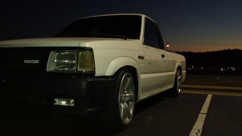

I had no narrow my rear about 2" and I'm running 18x8's with 2wd sheetmetal and 215/40 series tires. My KMC wheels are high offset (+35).
Note, I used to run escalade wheels and they rubbed when I was bagged with the stock axle. I ran 225/45/17's.
I have stock spindles in the front.
