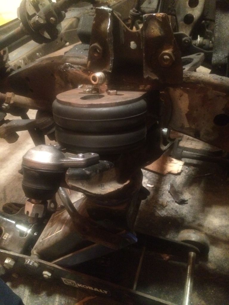

Ok as of right now I flipped the lower ball joints pie cut the upper control arm I have about 1 inch too lay I was thinking of getting drop spindles but maybe someone else has a better suggestion?

what size tire are you running? drop spindles should help but you also could step your lowers and re pie cut if nessecary

Im not sure of a better way than drop spindles. They give you an instant 2" drop and helpbwith camber

Are your lower arms hitting?

No the lower arms are good I notched everything. I'm going to try the drop spindles see if that will do the trick

It will definitely do the trick but it should lay on a 20 without them

maybe I didn't angle my upper bag bracket enough

Looks like that make be a problem

Well Looks like drop spindles it is! Thanks for the help I'll update on how it works out
