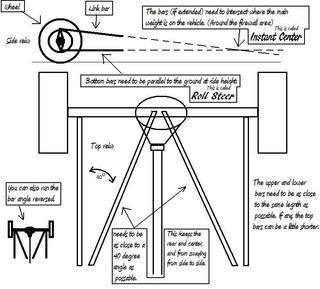

lowcolorado's avatar
lowcolorado
://img.tapatalk.com/d/14/05/26/ape9a9a7.jpg
Ok here goes some pictures does it matter which way I run my upper links on the rear end? Any benefits either way?
Sent from my iPhone using Tapatalk
mymmeryloss's avatar
mymmeryloss
Should be fine as long as it doesnt bind
vsawmike's avatar
vsawmike
Bind is the key word there. Any links mounted with the bushings at an angle to each other will bind. It's a small amount when the bars are long like in the pics above but they will bind. The bushings will not last as long as if they were all mounted in line.
Another place people screw up mounting bars is not getting enough angle. Too straight and you will have issues with the rear of the truck swaying in hard cornering.

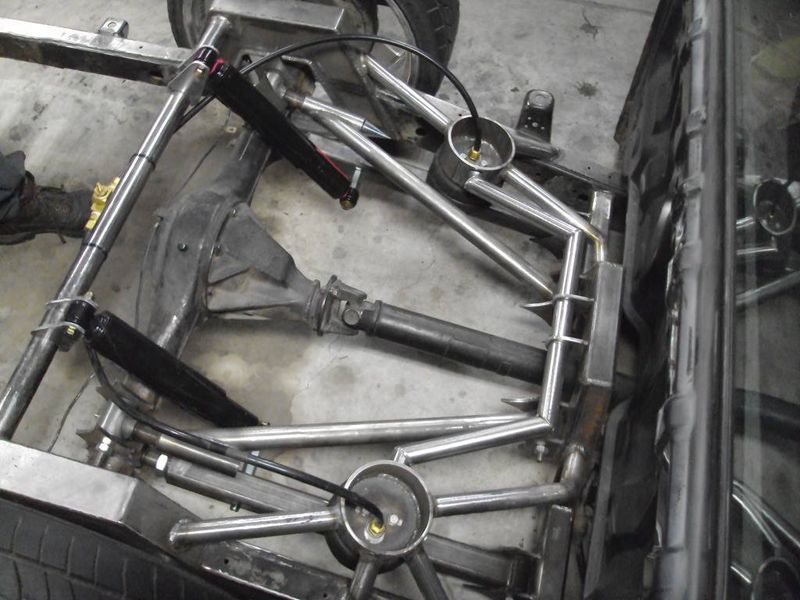

lowlyfe's avatar
lowlyfe
This is from my build log
