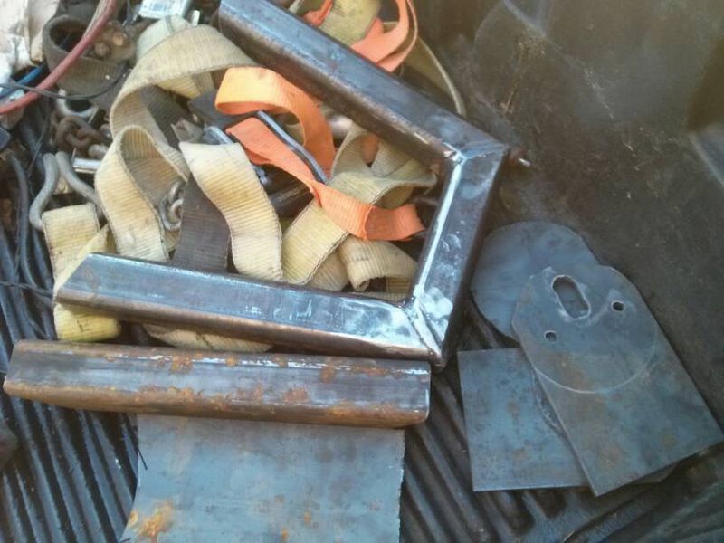

kylesj6033
Mine are 45 angles I can tuck 24s but I only have 22s
Sent from my VS950 4G using Tapatalk
kylesj6033
Picture before on my truck

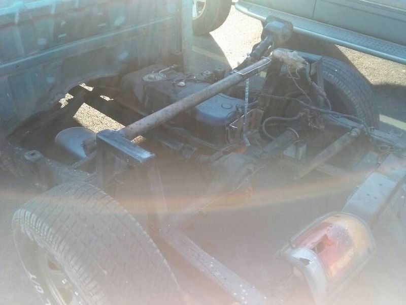

kylesj6033
After install and they are still on my truck today.

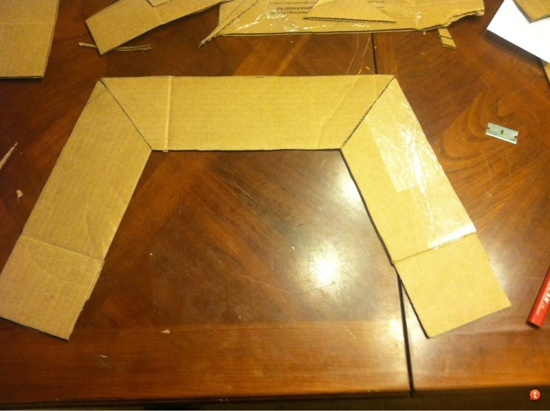

lowcolorado's avatar
lowcolorado
Ok I made some templates here ya go!
