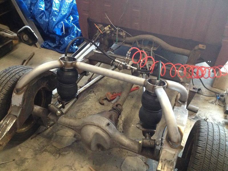

Got my front end all welded up and ready for shocks. Got the back end also ready for shocks. Question. How did any of you find the shocks you need. I know how to measure for shocks and where I would like them but how did you find the size you needed? Is there a site I can put in my measurements and it will tell me a part number of the shock I need.
