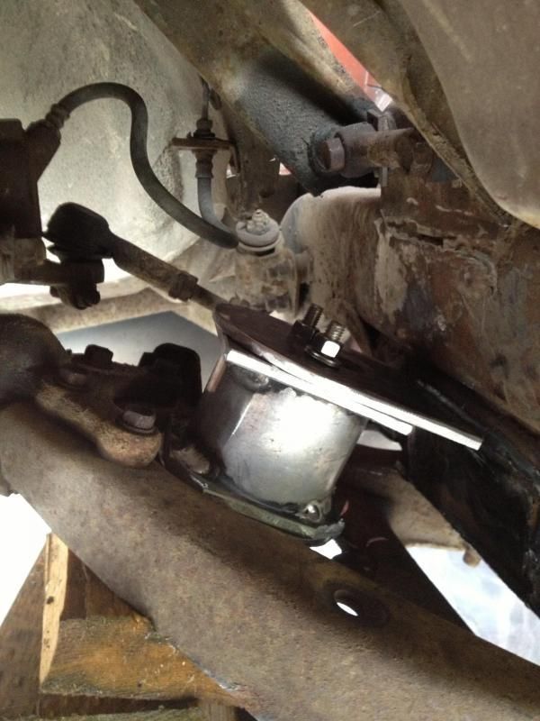

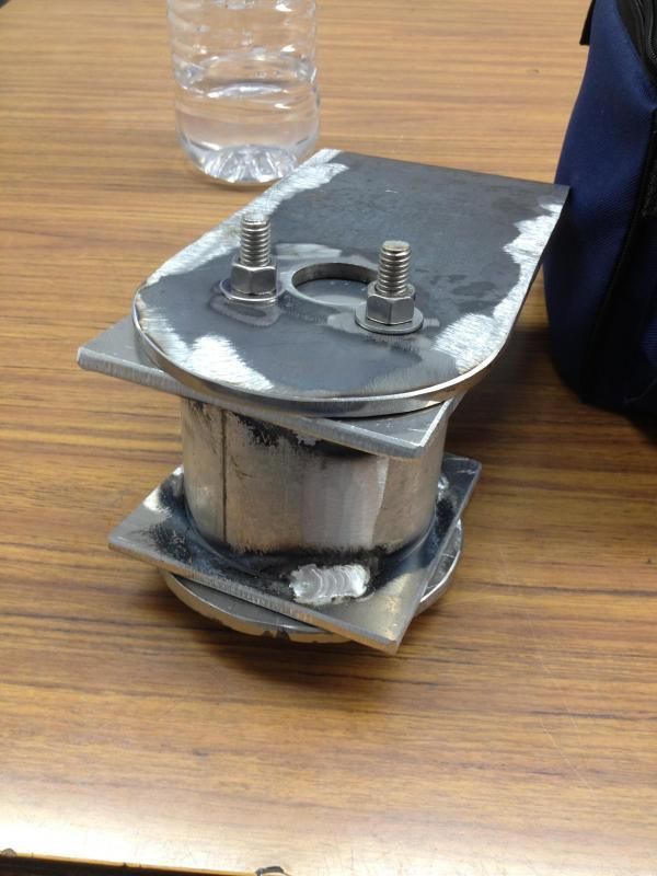

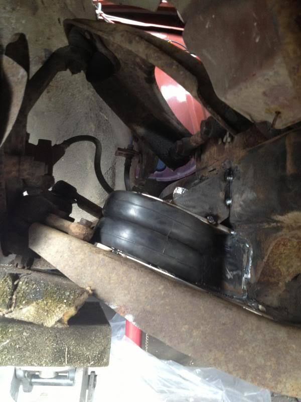

my truck has different arms, but i made a aluminum template the size of the bag when compressed and with holes so i can line them up easier. here is a few pics and it made lining everything up super easy.

The work looks nice but just for good measure, have you cycled the suspension to make sure everything is clear when they are aired up? They do change shape slightly with pressure and some balloon outward as well...

vajr86
Yes I have aired it up. Nothing comes close to touching bag and it does arc out a lil but thoes bags can handle the top and bottom plates to be 45deg from eachother and it isn't close to that

That spacer block is a good idea! I can see where mounting the bottom plate is better to do first so you can place right beside the LBJ. the top plate can then be cut and placed on the frame where it sits when deflated and collapsed without ballooning out.
