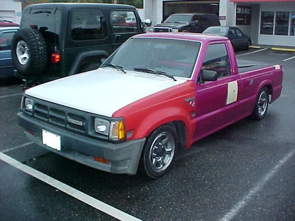

Putting air shocks on the front of a B is nothing new. It's oldschool. That's what we did before airbags. I used to have a standard cab I called "Spumoni" because every body panel on it was a different color.
It had air shocks front and rear. The rear would raise around 4" and the front had 2.5" to 3" lift.

Here's the only pic I have of "Spumoni", I don't have any pics of the airshock setup.
