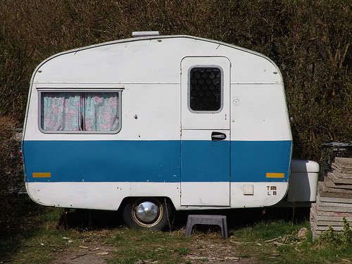

wanted to know your thoughts on towing with a bag over bar set up. nothing heavy, like a very small camper or b2200 truck bed turned into a trailer.
let me know your thoughts on this. I also have the heavy duty lower bars with gussets on them.
I would think it would be fine if the weight is with in the factory tow limits. How much tongue weight do you think it adds, can you lift and move the camper by hand?
PB
pimp b2200
I HAVENT PICKED THE CAMPER UP YET. JUST A VERY SMALL CAMPER. IM REDOING MY REAR SUSPENSION AND WANTED TO GET SOME IMPUT BEFORE I WELD IT IN. YEA I WOULD ASSUME OU CAN MOVE IT AROUND BY HAND. IM LOOKING AT SOMETHING LIKE THIS
Yeah I don't see it being an issue depending on how you set the bags. You would definitely need shocks in the rear if you don't already and the closer the bag is on the bar to the axle the better for this application.
PB
pimp b2200
I FIGURES AS MUCH. RIGH NOW MY SET UP IS FURTHER AWAY FROM THE AXLE. THANKS FOR THE IMPUT
