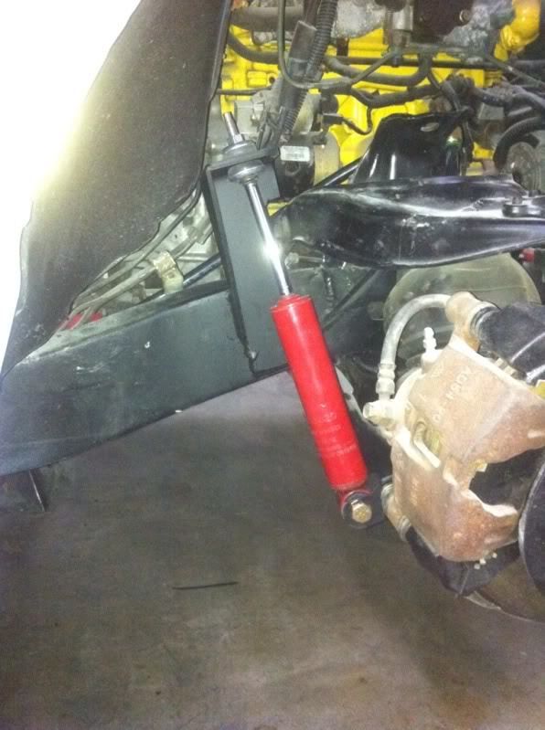

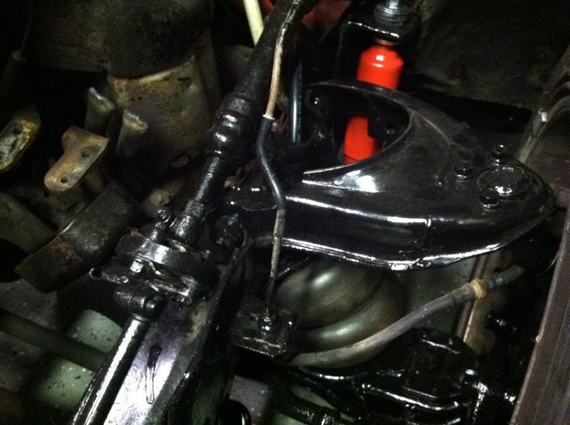

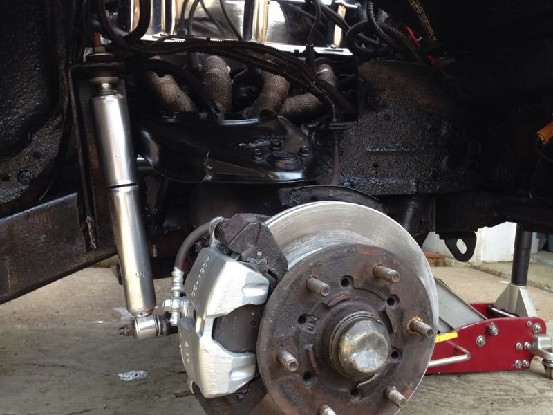

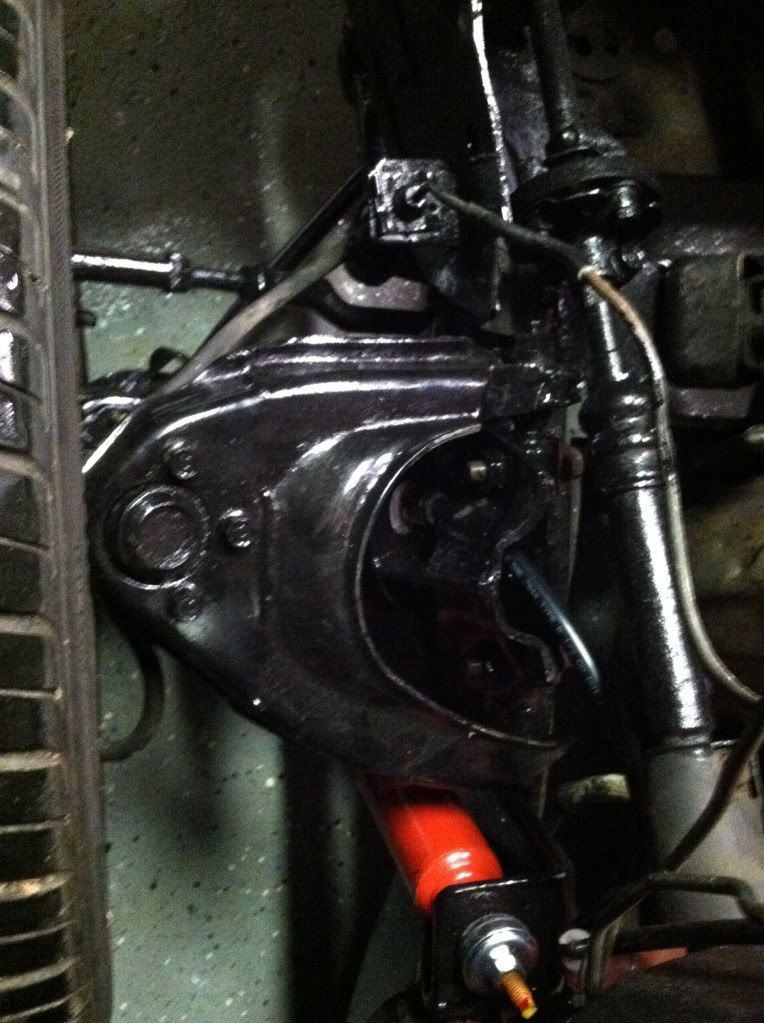

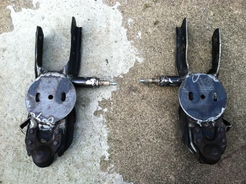

mazdizzle
Here's a pic of mine I'm still using the factory radius rods
kovz's avatar
kovz
Mine look same as Mazdizzle. I pie cut the uppers, but using stock radius arm and stock lowers.
