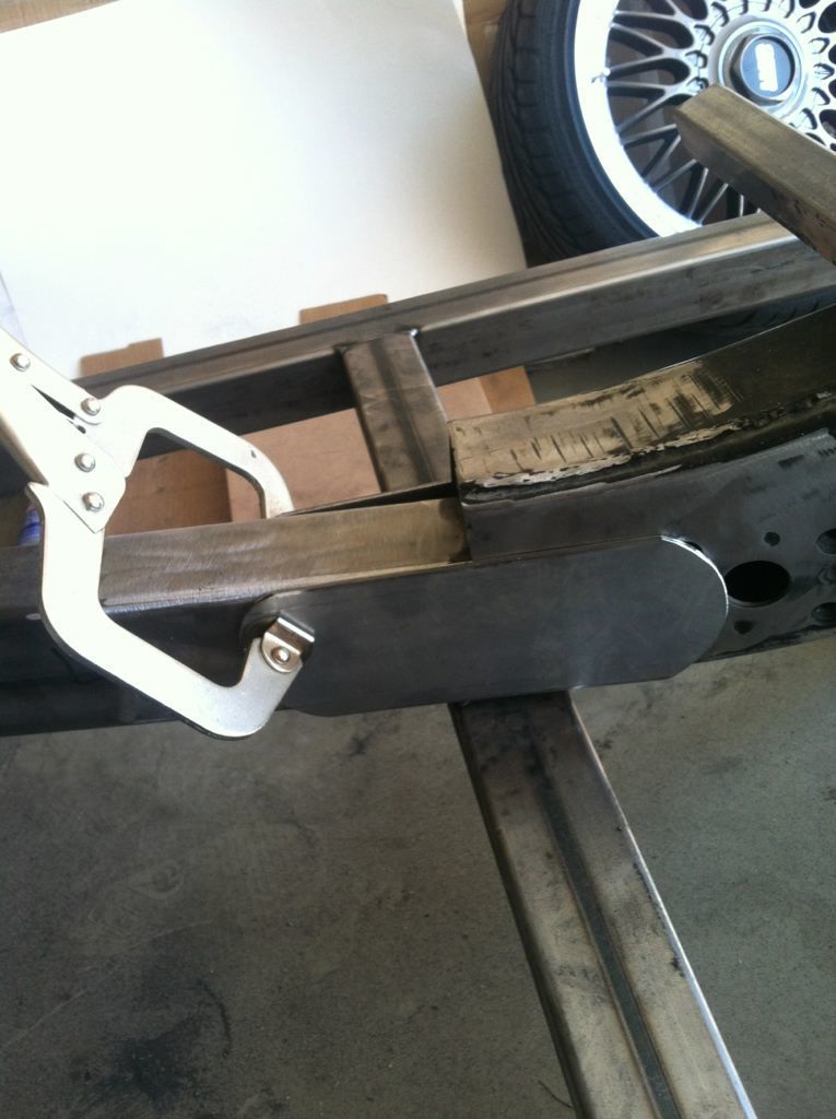

Hi I'm doing my sfbd soon but I would like to see pics of how others have done it My friend who works on trucks is going to help me but has never done a Mazda so I want as much info to show him. Back half I'm not worried about mostly where to and how to cut the frame and I see some people do 2 1/2 and others do 2 3/4. I'm running 20" rims and want to lay on rocker Please help with pics or links. I tried to search but couldn't find any good ones

I used 2x3. Are you chopping the top of the frame and putting square tubing inside or are you redoing the under cab section completely?

All new is what we want to do

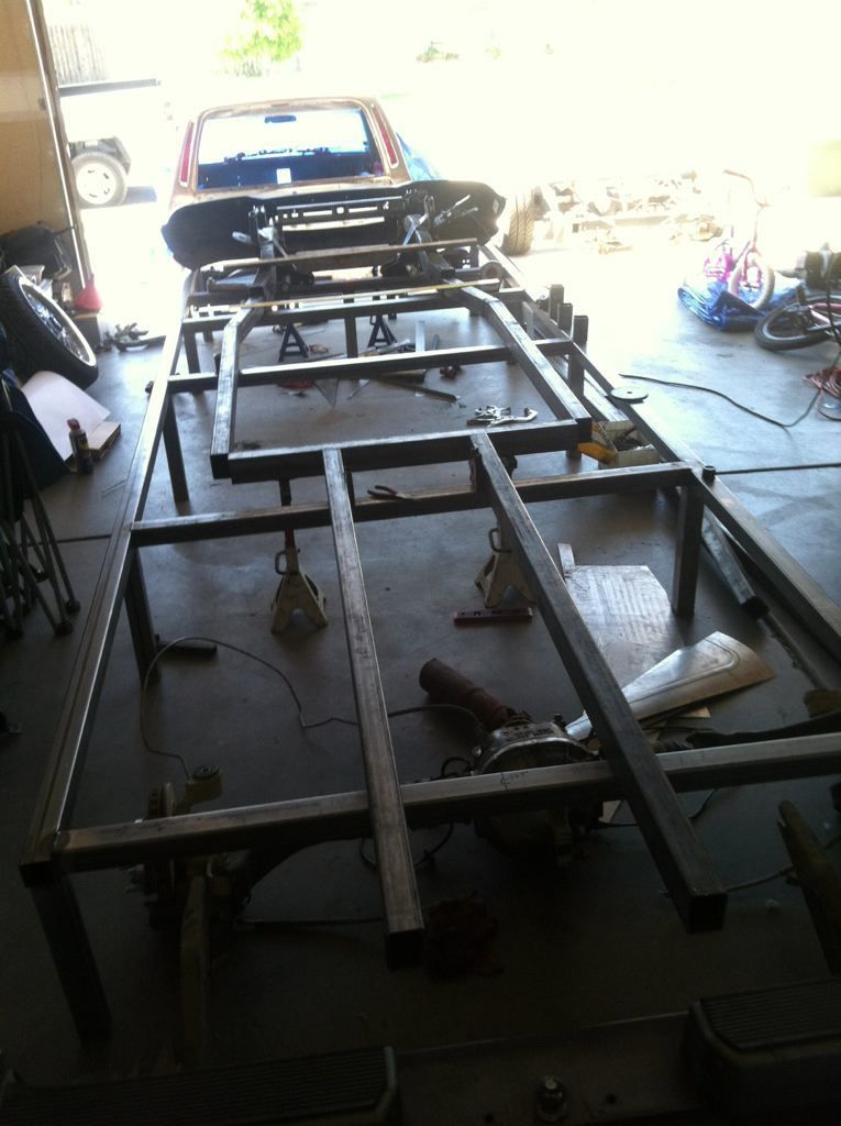

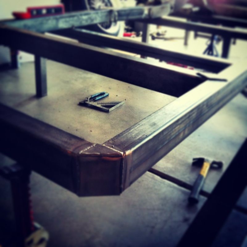

1/8" 2x3 with fish plates for this guy...

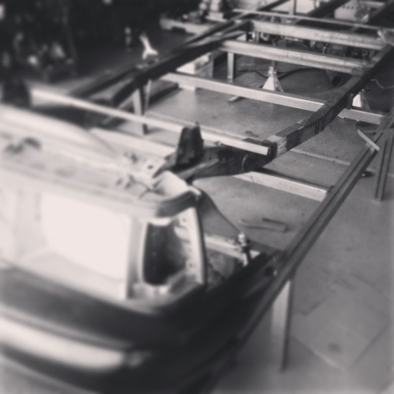

Thanks for the pics can I get one of the side where u tied the front clip into the new frame ? Thanks. Did u still shave the pinch And does it lay rocker ? Or not.

Ill try and get more pics. The truck lays door.
