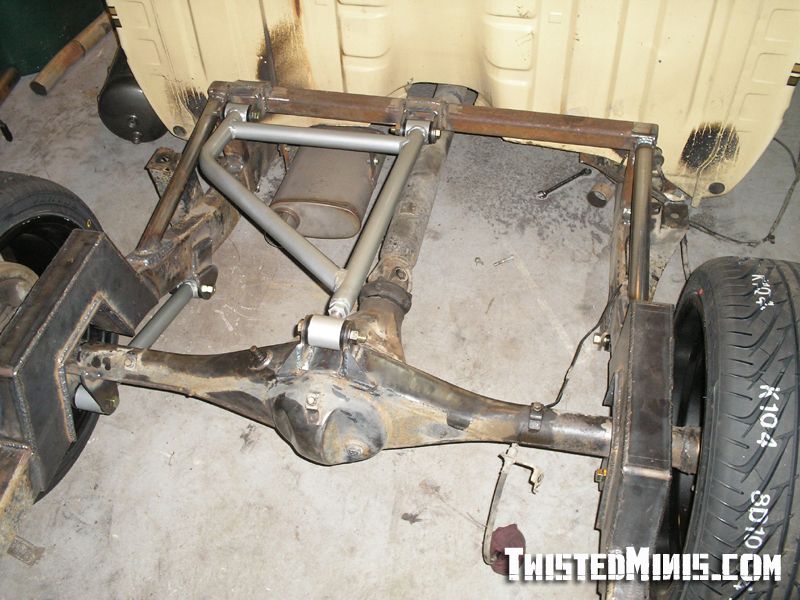

I'm as low as i'm going to get in the rear with my static drop so i'm looking ahead. I'm going to build a three link set up, and want to build a set of trailing arms that go right in place of the leaf springs. Anyone done this before that can give me aside on tubing size, wall thickness etc?

Instead of the leaf springs I will have trailing arms. I will use the third link to keep the axle from shifting forward or rearward throughout the suspension travel. My suspension will be hydraulics and I plan to work around my factory gas tank to set up and keep everything below the factory bed floor for maximum utility. I've attached a picture from twistedminis to show a three link set up.
