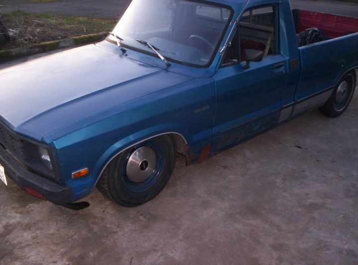

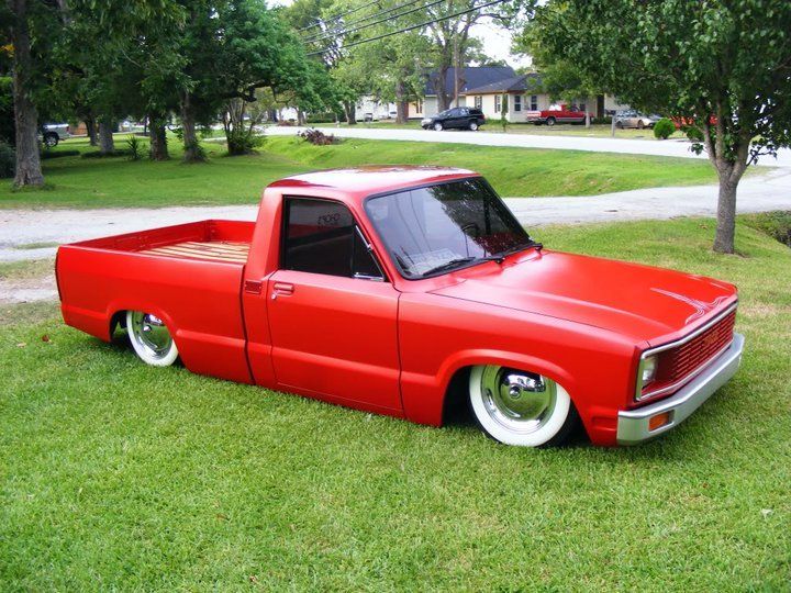

what kind of problems can i expect trying to lay out with behind the tire steering and how do i solve them i am running stock rims and tires
this is what i want
this is what i got

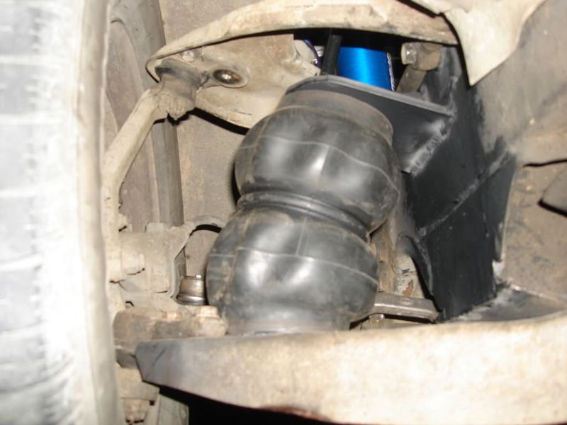

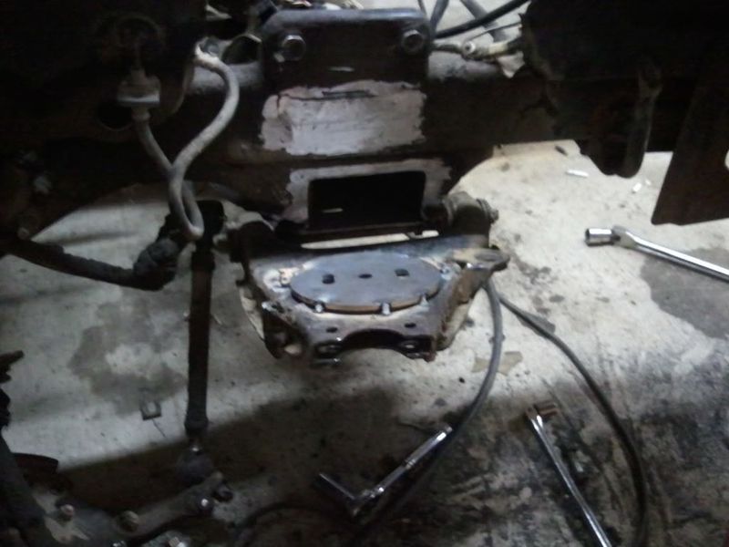

Should have no problems if the front is bagged correctly. Cut off the spring "bell", weld a filler piece in the hole that it creates in the frame. And weld in a "torsion" style bag kit. Cut out the inner fenders for clearance. Some need to piecut the upper arms, some dont, most do though
The gussets are facing downward on the courier, just forgot to take pics
