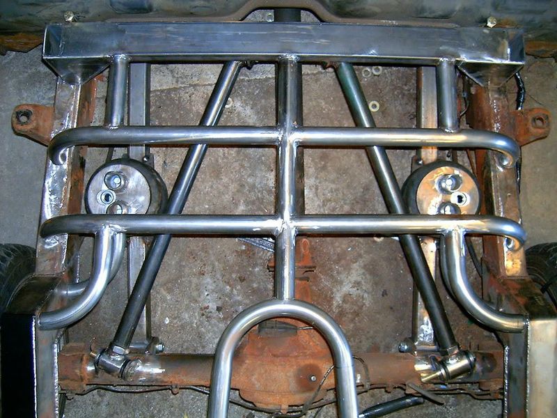

trplezro's avatar
trplezro

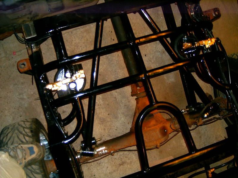

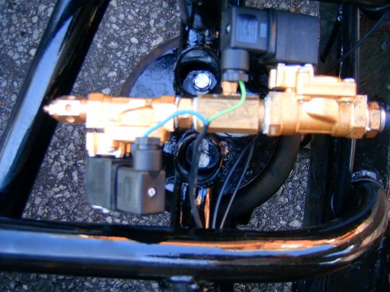

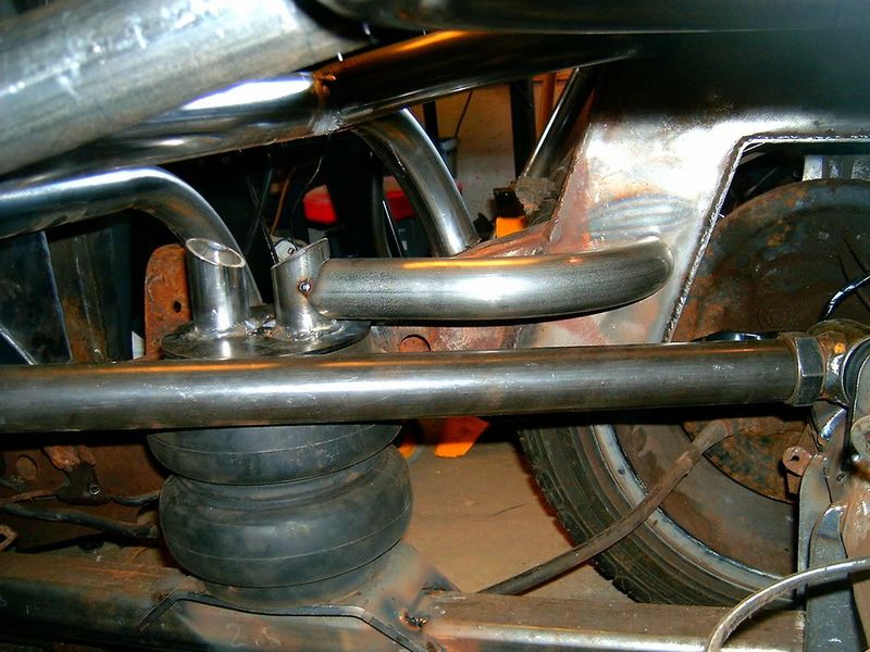

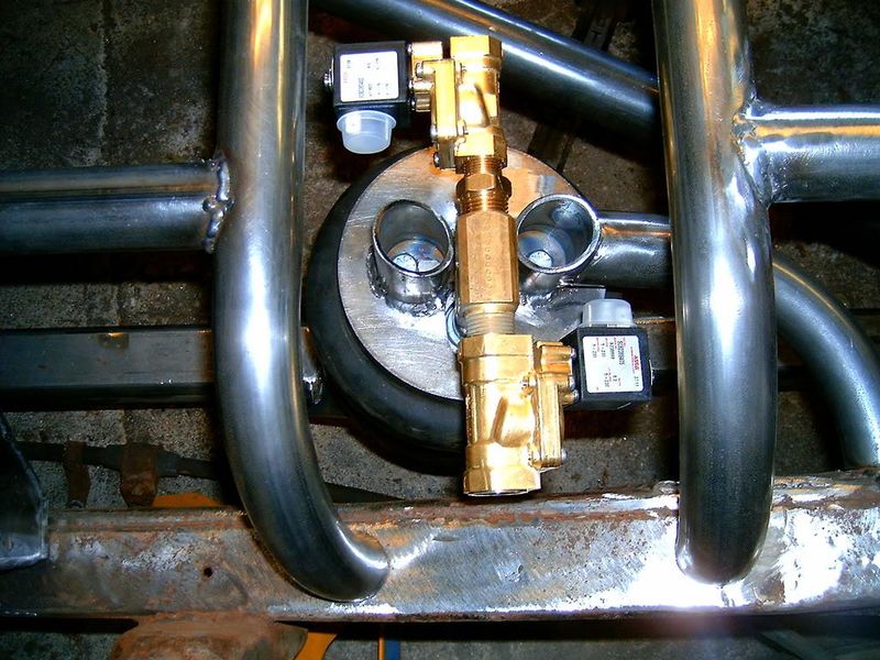

On my Courier..
At 80 psi
bratliff
That is basically identical to how mine was. Braced off the bed mount and everything. Good looking setup.

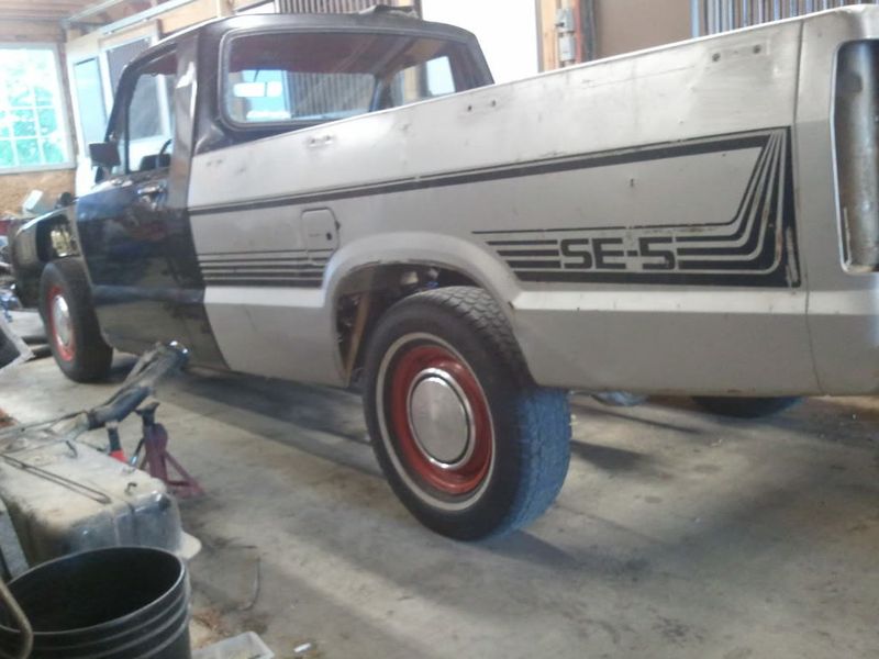

I will have to find them on my old hard drive. Need to scan pics of my Toyota to

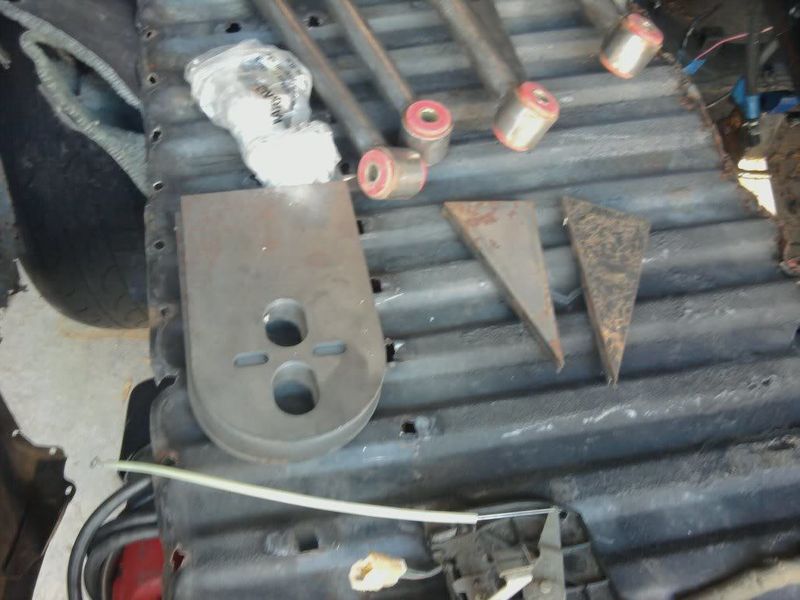

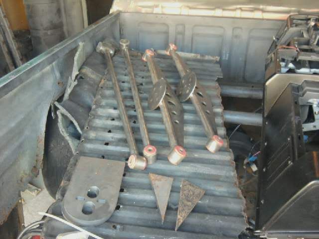

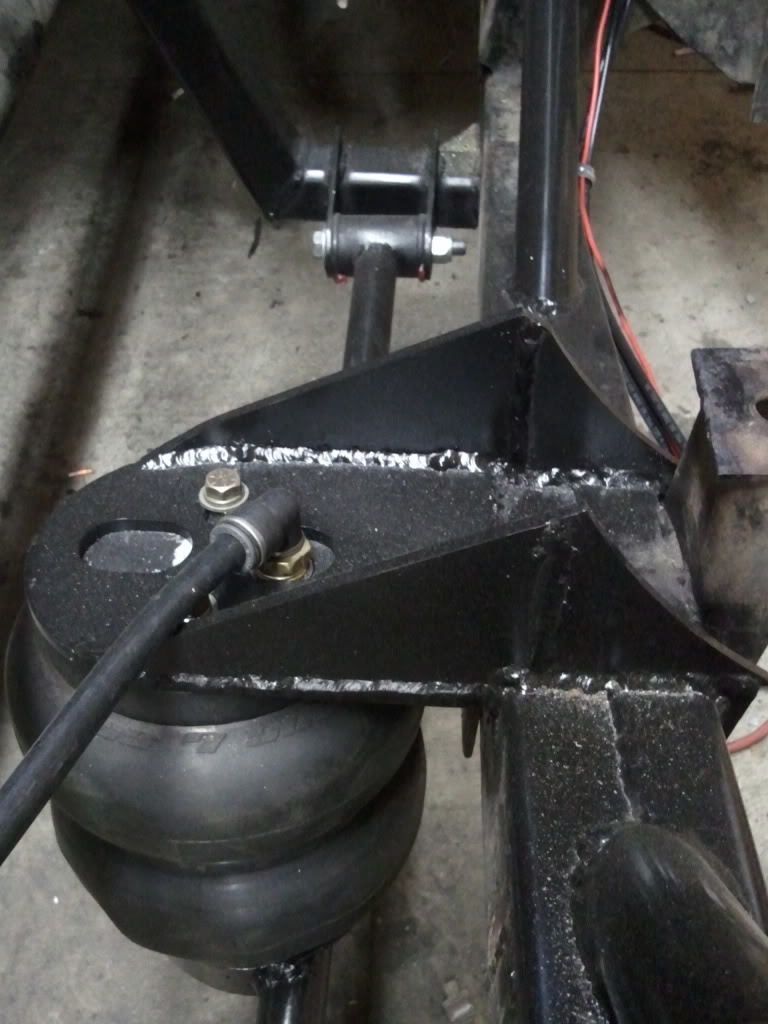

Well here are some pics of the bag on bar setup I bought. Just need to get some mounting tabs for it. They weren't there but i couldn't pass up the deal. Baha looking for mounting ideas and food for thought (my thoughts).Trplzro that looks good but what are the round bars for on your frame? Is that just for extra strength? And why so high on the frame? Also let see if i durvive telling the wife I am going to buy a welder this week. Haha
trplezro's avatar
trplezro
Yeah, the bars on the frame are for added strength and rigidity. Since I moved the gas tank to the rear of the truck I just wanted to keep it strong. I absolutely hate when a truck lays out and the bed sags, creating an obvious gap between the cab and bed.

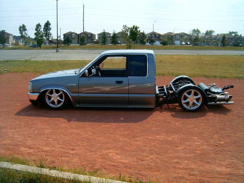

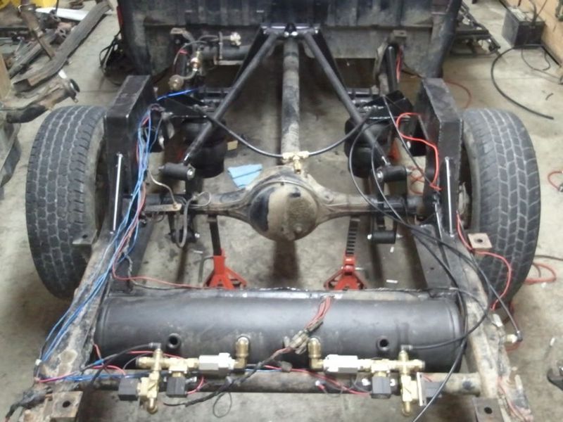

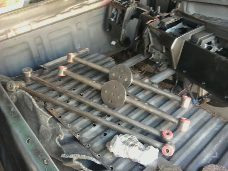

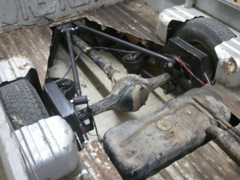

v8mazda4ever
Heres a pic of the set up I did in cids truck.
