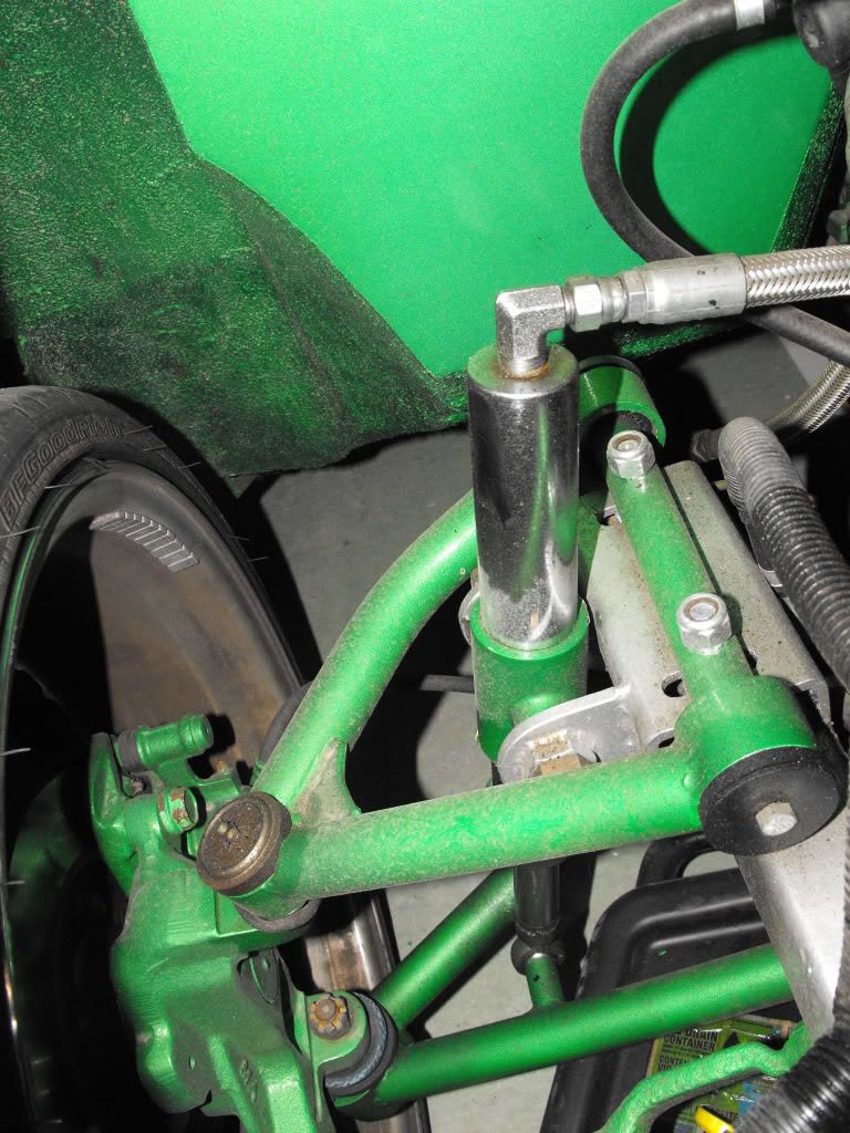

Sounds like you have a good plan. One thing I would suggest would be to design your upper cylinder mount so that it allows for some left/right pivioting as visualized from the drivers seat. The lower control arm moves in an arc and most likely you will have a heim joint for your lower cylinder mount. I believe Tre5's setup allowed this.

heres how mine are mounted very dirty been sitting all winter..

For mounting the upper part of the cylinder, the above is exactly what I was thinking about. Nice setup you have there DubD.

Linn - I indeed was planing for a method of mounting which allowed for pivoting of the cylinder. I assume with yours you have an issue with having to replace the pvc after time, depending on how often it's driven? I dig your truck, though I did like the Version 4 the best. Do you have a build thread for your green truck?
Dubddawg - thank you! That's exactly what I want to go with. I don't like how the other pivoting setups I've seen set the cylinder so far outward and in to the upper arms rewiring trimming on the stock arms. Yours looks like it would prevent that. Can you tell me exactly how it pivots? It looks like its just a piece of proper sized piping with two threaded buns welded to the sides and two bolts go through the mounting tabs to hold it all in place. Is this correct? Big thanks for the picture.

Actually with the coil springs and the way the PVC is mounted i have not noticed any wear issues. Version 4 of the truck did win many awards but was just too heavy to drive around which is kinda the direction I am currently going with it. The above link is for the green truck.
