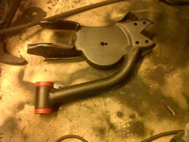

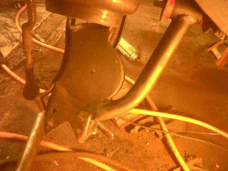

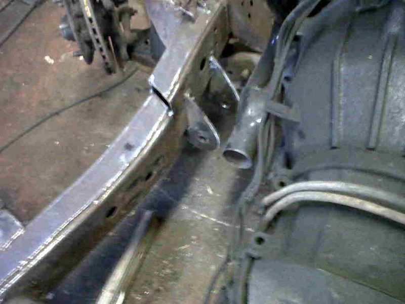

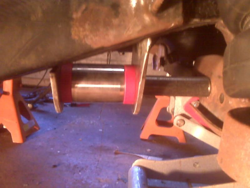

Here's my setup. Sorry I thought I had more pics.
NC4life's is probably cleanest I've seen I'll try to find pics of mine but it isn't as good lol
