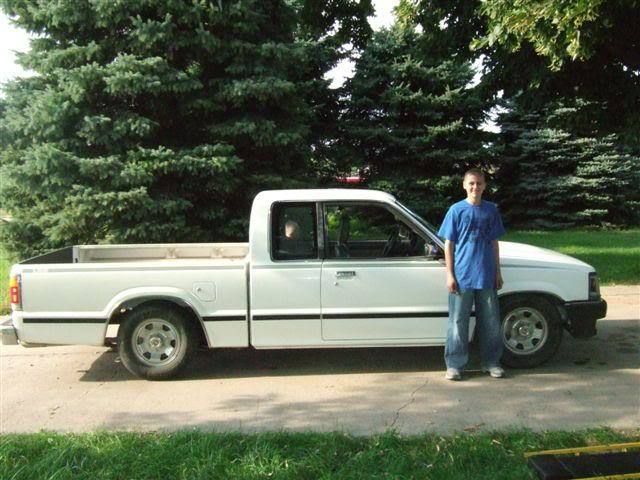

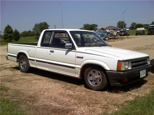

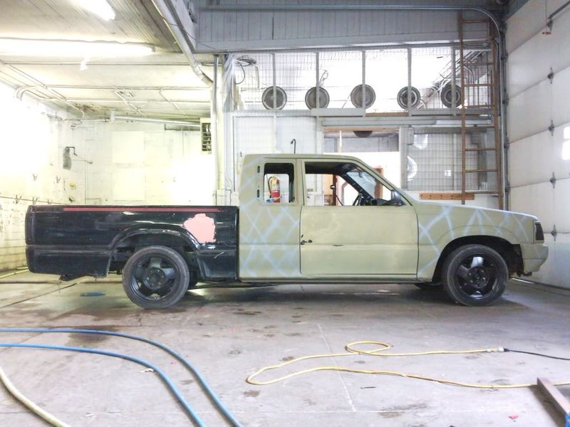

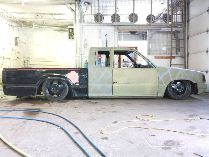

huskerdually
Year, Make, Model
1993 b2600I
Front suspension
All stock. reindexed torsions 2 splines. Bump stops removed.
Rear suspension
3" blocks, the rest is stock. Bump stops removed.
Body drop
none, yet
Air management
none, yet
Wheel and tire size.
stock 14" 205/75 14's in 1st pic
2nd pic 195/70 14 front and 205/75 14 rear
What you would change or do different
It needs shorter shocks in the front I moved all the bushing to the top to give it a little more room, but they are kinda noisy. We plan on bagging it soon so I haven't gotten real concerned about it.
Build thread
Post was last edited on Jul 22, 2010 05:57. Edited 1 time.

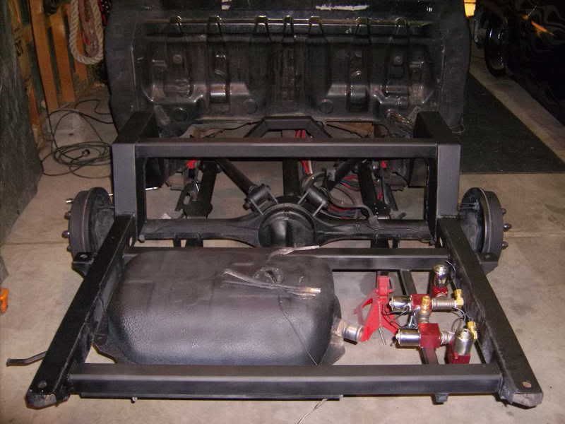

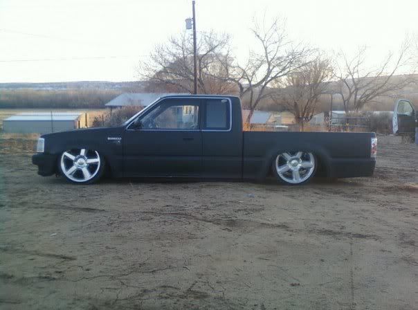

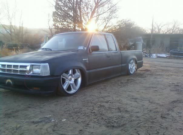

hunterw's avatar
hunterw
Year, Make, Model
1987 mazda b2000
FRONT SUSPENSION
AIM drop spindles
upper control arms pie cut like a mofo
denom 2500 bags (going to replace )
frame notched to fit bigger bags
REAR SUSPENSION
thorbecke bros super pivot bag on bars 4 link.
denom 2600 bags
8 or 9 in rear notch
suzuki samurai tank, under bed behind axle
BODYDROP
no body drop lol.
AIR MANAGEMENT
1/2 DOT airline
8-1/2 AIM valves
5 gal tank (being replaced with 12 gal soon)
sanden 508 compressor converted to a grease EDC
ELECTRICAL/AUDIO SYSTEM
battery relocated to bed
old system....
3 rd audio 15 HW v.2 subwoofers
3 rd audio d9 amplifiers
3 xs power d3100 batteries
pioneer premier 590ib headunit
12 runs of knu konceptz 1/0 wire from front to rear
mechman 280 amp alternator
secondskin damplifier pro deadener
new setup will be....
1- 18in subwoofer (undecided on which sub)
1-rd audio d5 amp
1-RF 600-4 speaker amp
2-6 in phoenix gold RSD component sets (4 speakers-4 tweeters)
custom door panels
WHEEL AND TIRE SIZE.
09 chevy LTZ OEM 20s
+32mm (fattire told me)
225/30R20 tires
INTERIOR
stock interior, painted black
WHAT YOU WOULD CHANGE
lots of things.
i am redoing my all my airlines,
a new bed so i can cut it cleaner
new bags (slam ss7s all the way around)
i replaced all airvalves
i want to tub my firewall and put fenders inthe rear
PICS,
BUILDLOG
Post was last edited on Jul 26, 2010 02:26. Edited 1 time.

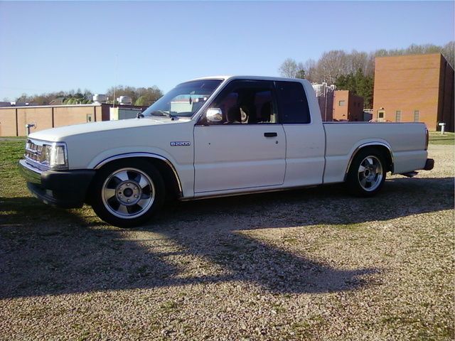

1hotdawg's avatar
1hotdawg
Year, Make, Model
1989 B2200 SE-5
Front suspension
All stock. Reindexed Sway-Away thicker torsion bars...not sure the spline count, prob 2-3.
77 Chevy C10 Monroe shocks...shortest Monroes I could find...cheap.
Bump stops and brackets gone.
Rear suspension
3" blocks, mono-leafed with overload. Air shocks, and soon to be 2.25" notched.
Bump stops cut down to about a 1/2".
Body drop
None and not planned.
Air management
One day
Wheel and tire size
Tahoe wheels, 16"x7", tabs ground.
215/55/16" tires, soon to be 50's or less on the front.
Nothing really. It will one day most likely be bagged, and probably go with some Eskies or something bright chrome for wheels.
Build/Photo Thread:
Most recent photos:

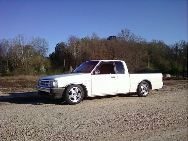

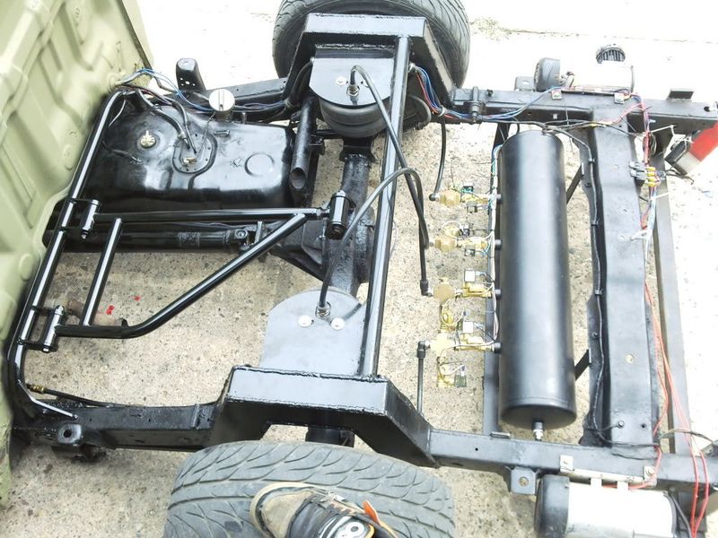

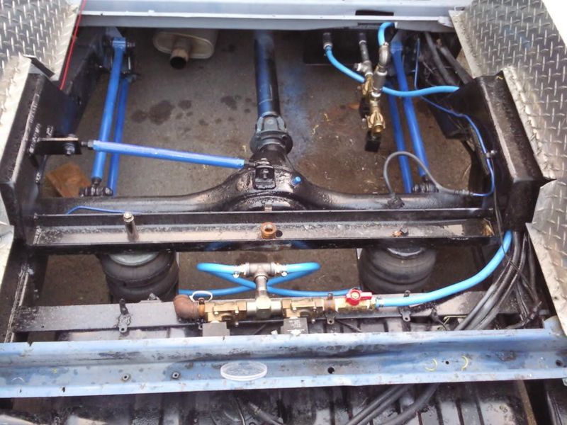

tucnrim's avatar
tucnrim
Year, Make, Model
1988 Mazda B2200
Front suspension
firestone 2500 bags up front, torsion bar mount kit
Rear suspension
Parrallel Link with pan hard bar
firestone 2500 bags
8 inch notches
Body drop
Not yet
Air management
1/2 inch vales, 2 for front and 2 for rear, smc
3/8 inch blue airline
Custom made 8 gallon airtank mounted under the cab
EDC up front and DC-07 3/4 HP compressor in the rear as a backup
Chevy Z71 16" rims with 45 series tires
Chevy Suburban 18 gallon gas tank done
Winter tear down to redo the mounts up front
get slam bags for all 4 corners
2 1/2 inch body drop and more

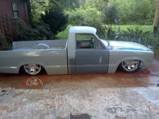

CS
canadian scrapon

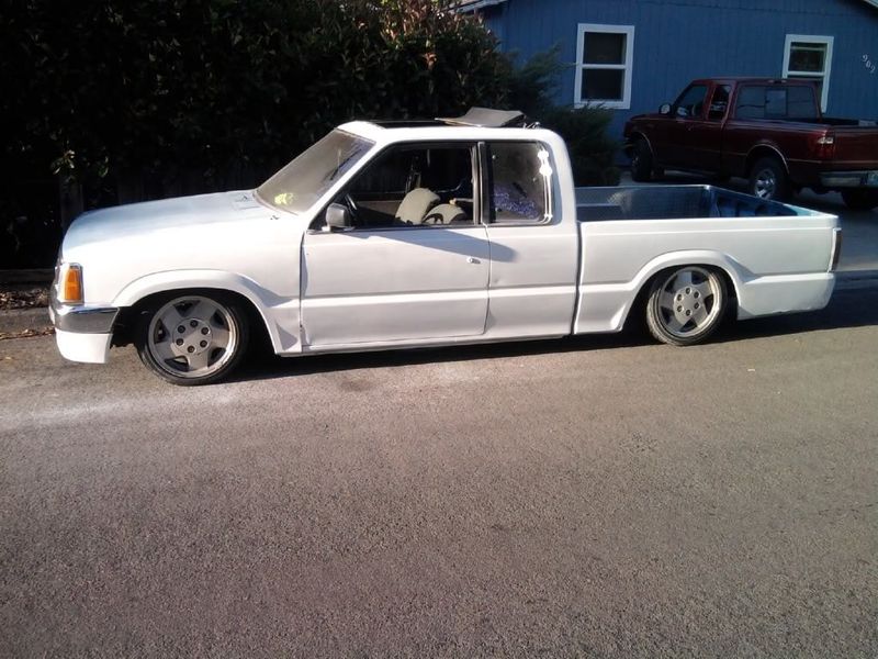

1992 B2200 reg cab/box
Front suspension
Cranked Torsions
Rear suspension
Mono leaf with helper on top
17" Escalades
205/40/17
Doing air now, piecing together a kit. All I need now is plates, 4 link and cnotch.
Sorry for the cell phone pics
(front has been lowered since)

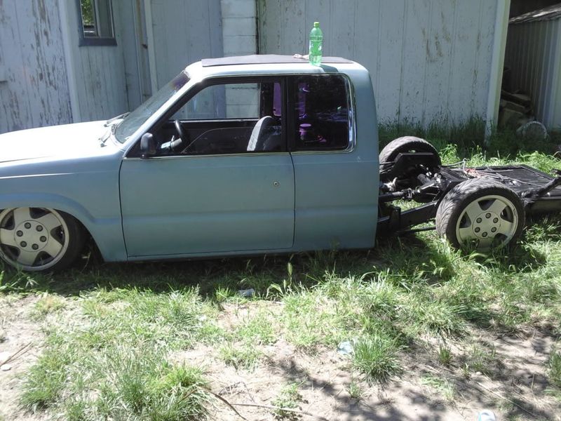

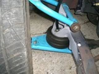

immortal1 (linn)'s avatar
immortal1 (linn)
1990, Mazda, B2200 (Immortal1)
Front suspension
Stock Spindles and arms (chrome)
Wedge kit to rotate upper ball joint (kinda like a pie cut)
8
