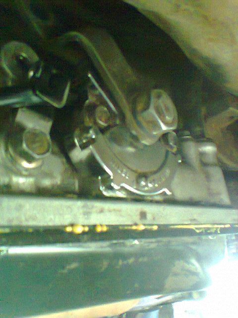

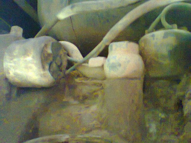

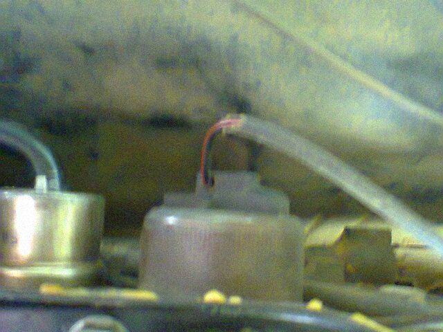

Ok, got under the truck this afternoon and disconnected the linkage, chocked the wheels, had someone sit in the cab and hold the brake while I manually turned the inhibitor switch into each gear. Still got the same response unfortunately when reverse range was engaged. On my phone at the moment, but I have pics of the switch and some solenoids/vacuum modulator I will upload when I get home.
rolentogrenades
Inhibitor switch
Vacuum modulator.
This truck is pretty dirty underneath, so I've been slowly scraping all of it off of the components.

check the vacuum line, does transmission fluid come out?
rolentogrenades
emjay,

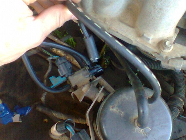

Ran the truck today after putting in a new air filter (never had one from the previous owner). Then I got underneath after shifting gears back and forth and putting in park and disconnected the vacuum modulator vacuum line while the truck was running. All it did was suck in air, no leaks. I also checked some vacuum lines on the intake side of the engine and found this vacuum port busted at the nipple. Disregard the larger vacuum section, I just put that over it in an attempt to temporarily connect it to the busted port.
It's a line that goes to the charcoal canister. Doubt it has anything to do with the reverse, but I'd still like to fix it.
