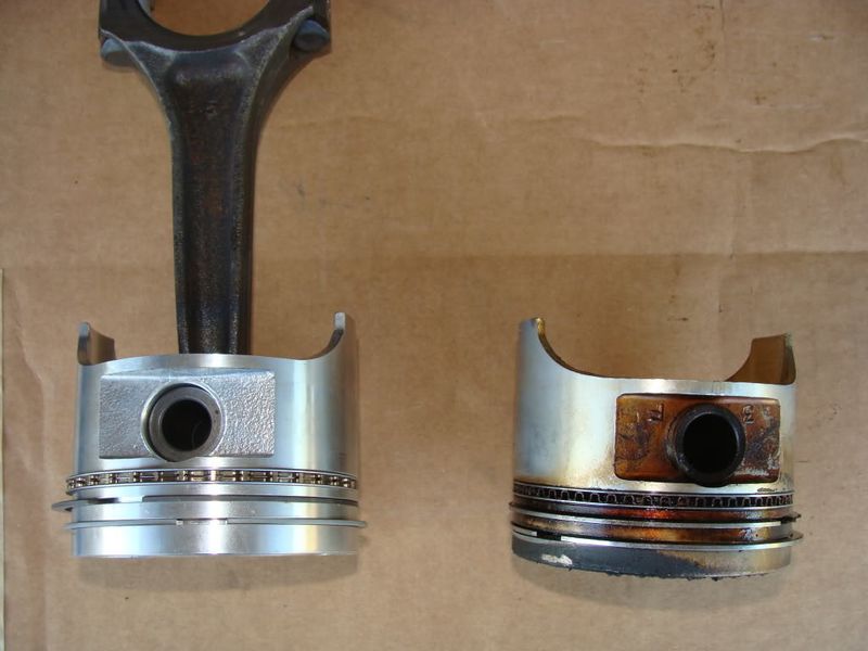

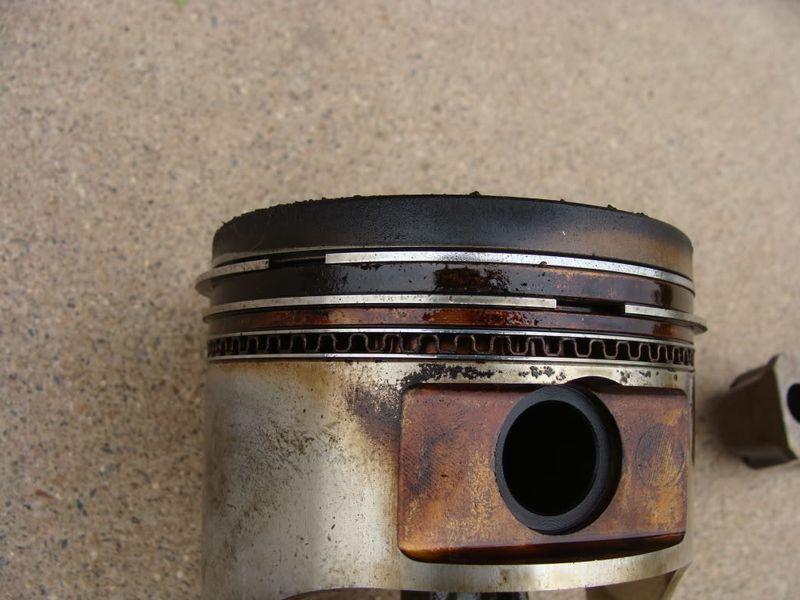

I understand from the later posts that you are replacing the rings, but was smoking the only problem?
Did the truck act like it didn't have any power? Maybe the catalytic converter is clogged with oil.

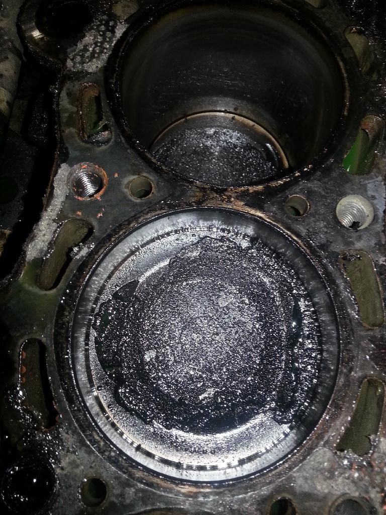

1. By now you probably have had a chance to see the bevel on the block where the pistons go into the block. The cylinder sleeve doesn't contain a bevel on the crankshaft side, plus the crankshaft is in the way for a straight push of the piston back into the cylinder.
2. A block of wood and a 2 lb sledgehammer will break the seal of the RTV. Don't use too much force.
