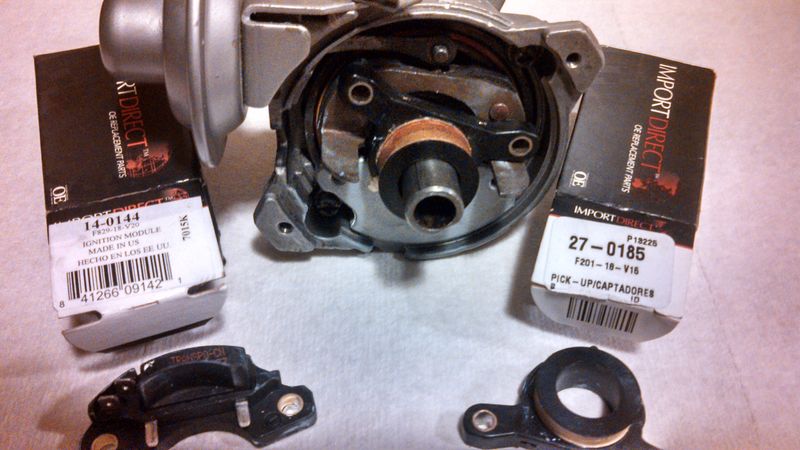

timb
this is the distributor I have. pickup coil and module are different !!! I have tested this thing every way I can and it will not break a ground!!! I ordered new distributor yesterday but O'Reily's backordered it and so did Advance . checked all local junk yards and no go. I will pick up one from ebay,I need a 1987 or older. ALL THIS WORK and a small part is killing me

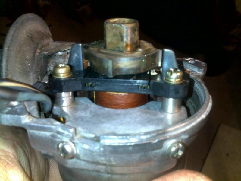

I have a small update for you Tim. A friend was having some trouble with the factory ignition system on his 89 B2200 so I let him borrow my Crane box until he gets a new CD setup. Being that his has the late model distributor I had to modify it like I did for my 86 and I found that the late mode unit is actually easier to modify than the early one
Here's a couple of pics for you where I removed the module and jumped it out. Truck runs great now
ICM removed and standoffs installed to make up for the difference.
*Note - When we shot it with the timing light it was 45
