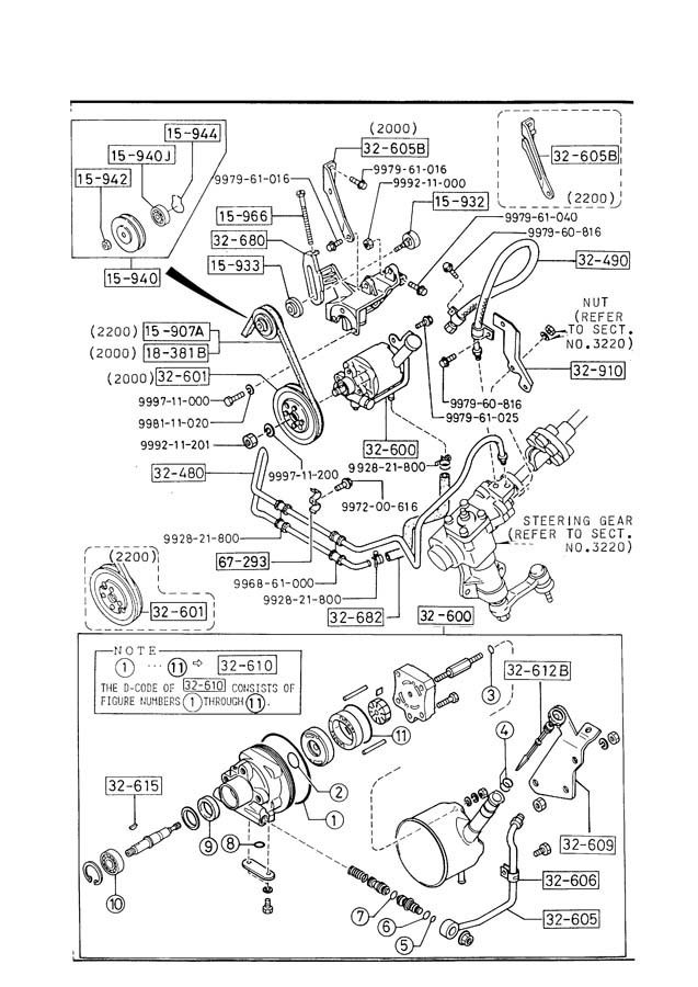

That's right Cusser, the alternate "pivots" on a long bolt at the bottom and is held in place by a 14mm (I think) at the top on a small metal bracket hung from the passenger front of the engine block.
The power steering is adjusted by loosening the large 22mm nut going through the PS idler pulley then turning the long bolt 15-966 (middle center in pic above). Clockwise tightens the PS belt and counter-clockwise loosens it. this action "raises and lowers" 15-932 (upper right center of picture above) - the bolt that goes through the back of the PS idler pulley.

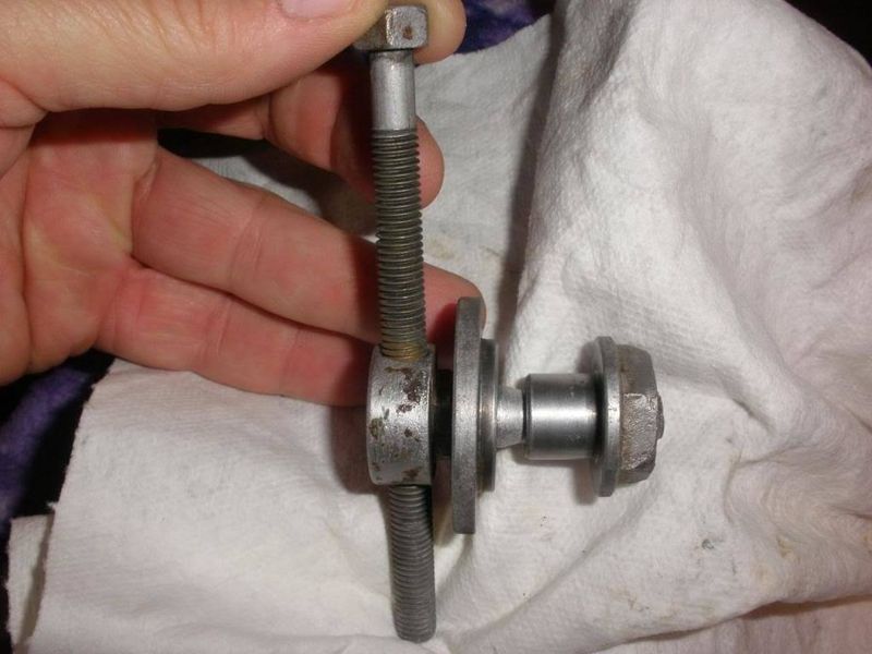

In this picture the idler pulley fits between the large shoulder washer and nut on the large headed bolt . That assembly is moved up and down on the large threaded bolt... The large headed bolt slides up and down on the groove in part number 32-860 (the PS pump bracket).
