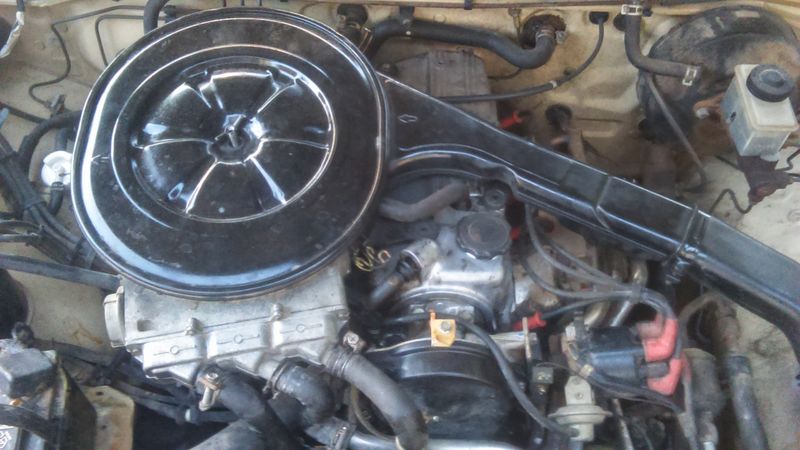

Do you have any pictures that you can post of the engine compartment?
And where are you located? There are members on here from all over the US & Canada......even outside the US........if your near another member, some of us would be willing to help you out in person.
8
87b2k
I'm located in Abilene, TX. We don't have emissions here. Anything specific on the engine bay for pics?
axel breaker earl's avatar
axel breaker earl

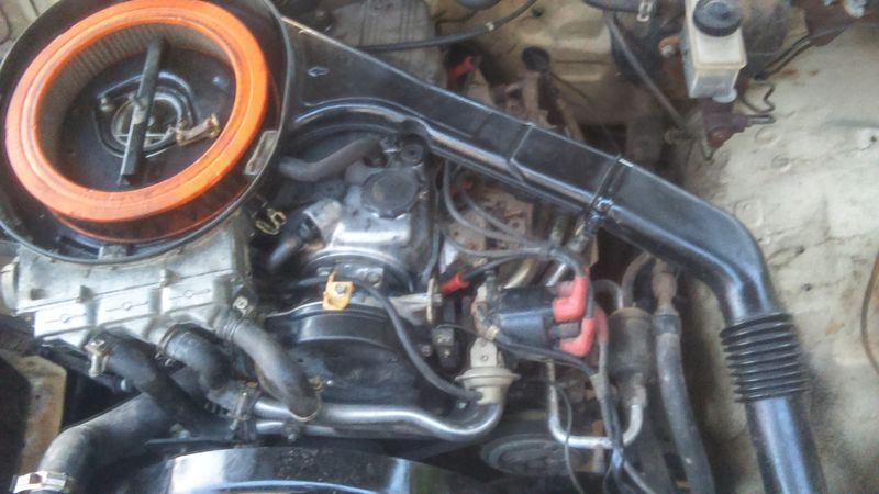

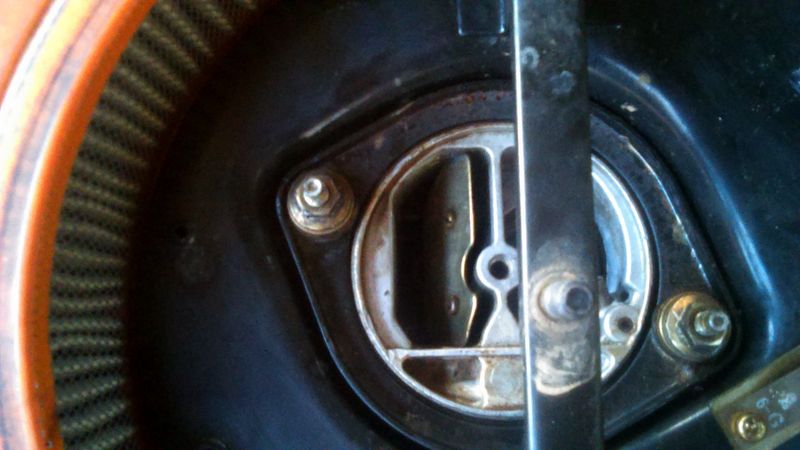

If you can pull the air cleaner and take a few pics of the carb and it's 1000 vacuum hoses, we might be able to see if some of them are connected wrong, or disconnected.
The passenger inner fender area would help also......lots of hoses & wires there. A lot of times, previous owners will tinker with these carbs and their vacuum hoses and actually make things worse........not saying we can fix it, but it just might help if we see something that is out of place or connected wrong.
Welcome to the forum also!
8
87b2k
This is what I got. It's getting dark and I can get some better pictures in the morning.

Actually, I meant remove the whole air cleaner.......so you can see if all of the vacuum hoses are where they should be......and connected. It's just too hard to tell if all those hoses are connected with the air cleaner in the way. Be careful when removing the two 10mm nuts inside the throat of the carb......you don't want to drop them into the carb.
