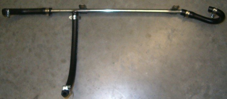

Make sure the leak isn't coming from the two little rubber bypass hoses on the passenger side of the engine.

Visually and hand feel these 3 intake hoses for leaks from coolant!!!! If these have not been replaced I strongly suggest doing so.And yes the part #s are readily available if you would like.Imo these trucks do not generally go through intake manifold gaskets.Could be one of the three hoses under the intake blowing coolant on the valve cover.
