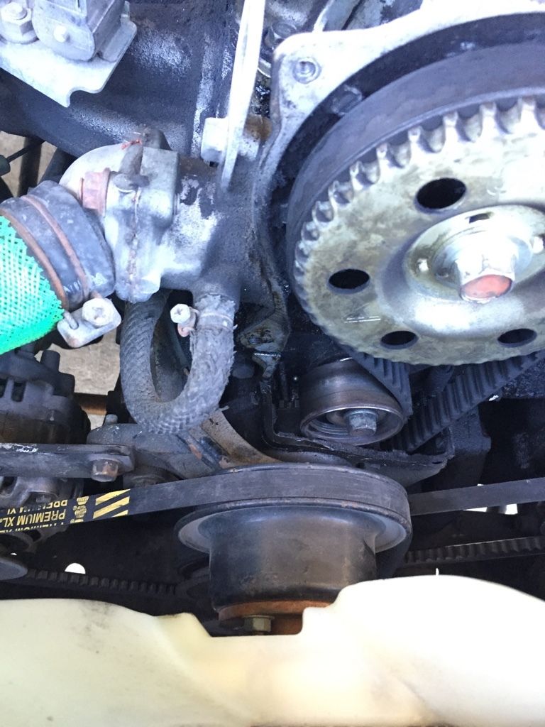

Well i figured out the problem. Im not really to smart when it comes to motors. My buddys dad came over and we took off the cover for the timing belt and the tensioner pulley broke. Bearings were everywhere. Thats what sounded like stuff hitting the road.

That sucks but good thing you found the problem. Might be time to replace everything under there now. I wouldn't take a chance on the belt not being damaged by all that stuff flying around in there. If old you might want to look at the water and oil pump too.

That small coolant hose that does a 180 looks pretty old and questionable also, and there are 2 more just like that which are hidden. I had one of the hidden ones split on my while driving down the highway, did not notice until I had no coolant, which warped my head and blew my head gasket
