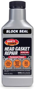

As a former cooling system specialist I also do not suggest using anything. However if you have to get by for a while you need to avoid things that will stop up the system. The ONLY brand I have ever seen work and not stop up a cooling system is Bars Leaks, Now days they have several different ones. The older one that was brown pellets suspended in a liquid was the best because it did not stop up the radiator and it did stop a leak.
I suggest this one..
But The other head gasket versions of bars leaks work well also. I do not trust any other brand.
But I do know that many of the ones that contain copper will also work.

Thanks VSAWMike! I am going with Bar's product. Maybe I can get a few more miles on my truck and do the head gasket later. It is a small leak... which should help the Bar's product do it's thing. I will let you know how it goes.

I researched the different brands and decided to go with Bar's as suggested by fellow member VSAWMike. I followed the instructions. Results? Nothing short of amazing!
I drove today over 100 miles non stop in stop and go traffic here in Phoenix. By the way... the temperature today was over 107 today... and I had my A/C going the whole trip.
Results... my coolant level remained full the whole time. I will keep you posted.

Well... as most everyone knew... A band-aid is exactly that. My truck is on the tow truck heading for a shop to get a new head gasket. Arizona 110+ temp will let you know who's boss around here.
No worries... i want the truck fixed right and while we have the head off... we can check everything else. More later...
