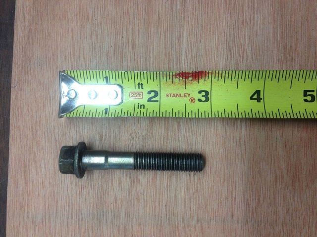

THEN...as I'm scratching my head I look on my bench and see this bolt. I can't help but think that this bolt and my leak have something in common....I guess it could be a bad water pump right out of the box though. What do yo think??
Either way, I get to tear it all apart again.
Anybody recognize this bolt?

Ouch, might be a classic case of "what is this bolt for?"
Open her back up an look at all your connections/mounts/bolts.
You will probably need a new gasket and clean all your surfaces again. Also check to see if there are any gouges in the mounting surfaces
(if you find all your bolts are present).

Verdict is in: brand new water pump is bad. It appears that it was assembled without a seal on the impeller shaft! I'm a little disappointed.
Btw, the mystery bolt holds the lower coolant pipe on the front of the engine block
