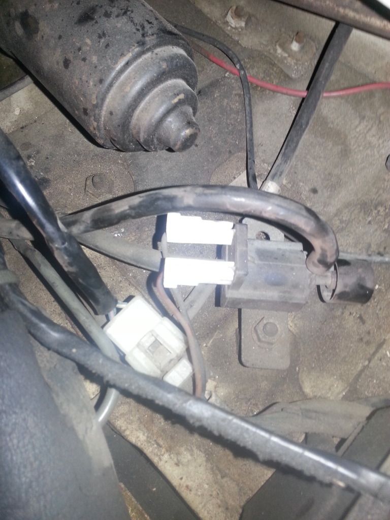

Its missing bad and I dont trust it. Only seems to miss really bad under load. Oh and she wont idle. There is some sort of vacuum thingy that has a busted end on it and I couldnt tell you if its been that way the whole time or if it is a new injury. It is coming off a thing that sits above the firewall. I'll post a pic in a second.
