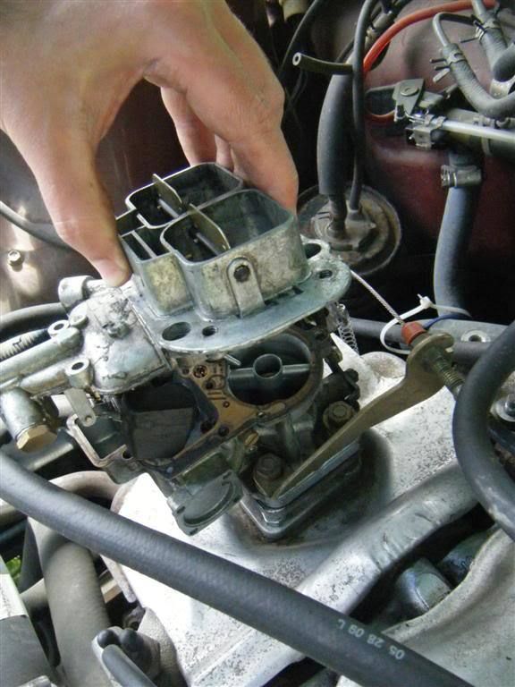

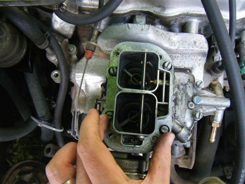

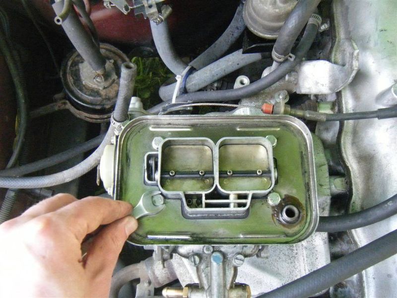

Take the air filter and the plate under it off. Under that you'll see 6 big screws, take those out and also the c-clip on the choke linkage. The top of the carb will then come off with the float attached to it.

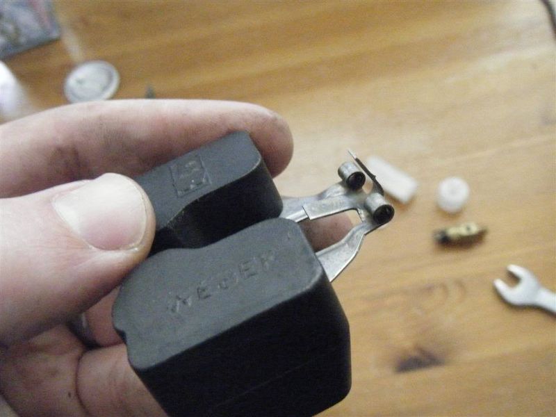

Then adjust the float level by bending this tab.

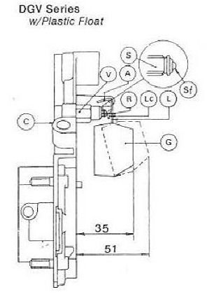

This is how you measure the level, those numbers are the max level and max drop. Set them to what it says in the pic.
Hope this helps
