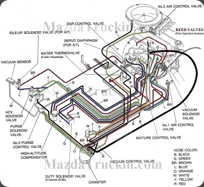

can anyone help? i need a vacuum diagram for 86 b2000
mazdafvr

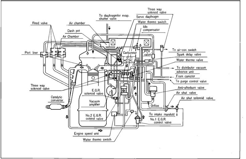

i didnt have the patience lol too many hoses but maybe u can make some sence of it.
This is for B2200, might help though
mazdamobber
This is freaking nuts. I am a little lost here with all of these hoses. Are the vacuum diagrams the same for the 2000 and the 2200. as far as i can guess they are, but im not sure. I also have an 86 B2000. and is there any easy way of dealing with all of this confusion? from what I am seeing on my truck at least like 10 of these stupid lines are crossed or just completely out of place.... Please assist with any info possible!

Do you have a specific problem you are trying to fix?
The only way to figure it out is pick a line or device and trace the path from one end to the other. Then pick another and trace that path... before you know it you are done - don't look at it as a whole.

Then you have two choices look at it yourself or take it to a shop. If you choose to do it yourself use the diagram above and start with one part and trace each line. Start with a part with a vacuum line attached, mark it and trace it to the other end. - then mark that end. You can make them with tape or something else you choose.
After you get done with a few you'll start to see a pattern in the hoses and recognize subtle differences in the lines. Some have dashed lines others solid white lines etc... Some even have colors.
Another option is to post some pictures, someone here or at MazdaTrucking.com may "know" where some of them go.
