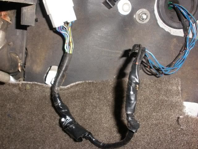

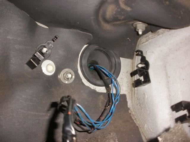

Merciless... Everything can go from the passenger side wiring harness except the black ground(s) and the blue wires (3?) that go to the wiper motor.
I did the weber 32/36 swap last winter. I'll take a photo later and post it for you. I can't speak to the cruise control but I'd guess it's not in that harness.

Here are the wires from the inside... There are four blue wires and I kept two black ground wires for future use... I suspect the cruise is controlled by a separate module not the ECU.
I taped them off initially and now that the dash is out I'll tidy those up and solder the wires I cut when I removed the Carb and emissions computer.
Hope that helps.
Dan
