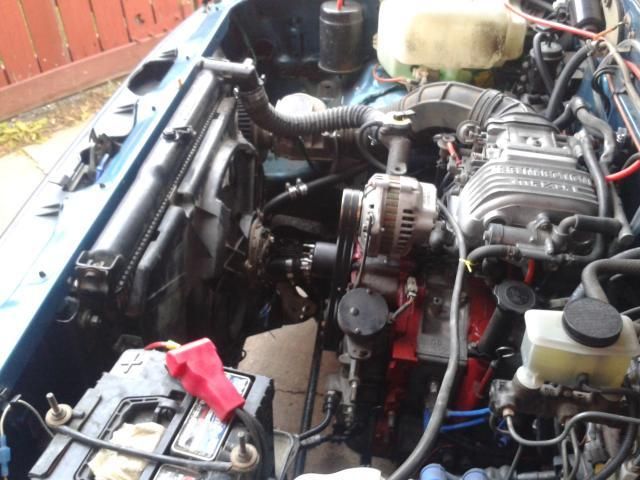

I went searching at the wreckers for a suitable rad, found some good ones, however they had nowhere to hook up the heater core return. I installed the RX7 radiator, the outlet angles are not great, but it had a nipple for my heater core. The only other problem that I didn't realize until I installed it was that the rad cap on the motor is lower than the top of the rad, but the RX7 rad has a low coolant sensor at the top, and with a small funnel, I can fill it from there. I also installed a 2 speed Ford Tarus fan & shroud, which is almost identical in size to the RX7 rad. Took it for a test drive, and it seems to cool much better, didnt have to have the fan on all the time, and when I did have to turn it on, temperature dropped over 2X faster than with the B2200 rad. The main difference between this rad an the B2200 rad is thickness, the RX7 rad is over 2X thicker, giving it better cooling capacity.

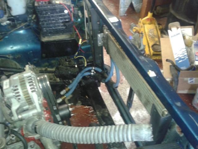

Oil cooler mounted, was previously mounted to B2200 rad bracket, now on its separate mount:

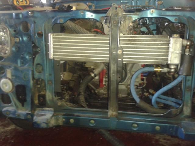

Just about touching the support, with grille on, it looks like an intercooler lol:

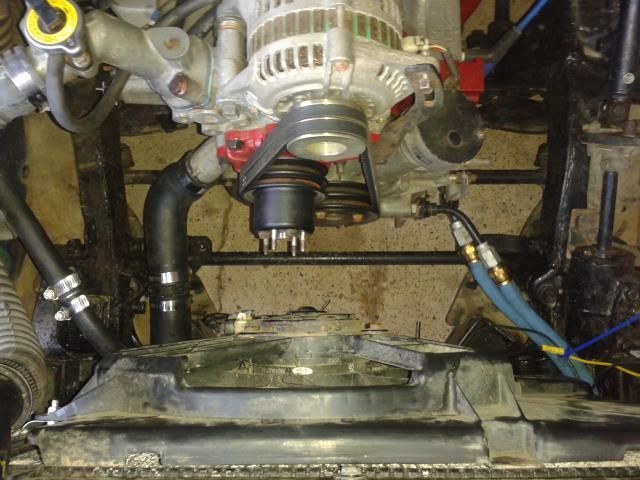

Rad mounted with new fan, much cleaner than before:
I now have a decent sized gap here, need to find some pre-moulded rad hoses that look nicer than the flex hose on top, and 2 hoses on bottom, I just used what I had laying around for now:
