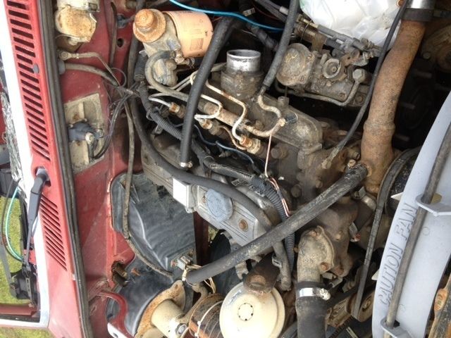

pic???
justinodono's avatar
justinodono
E
emjay
Ok that should be a Perkins, not too sure though as I've never seen one in person. Definitely not an RF or R2 diesel.
