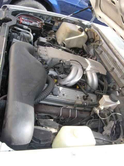

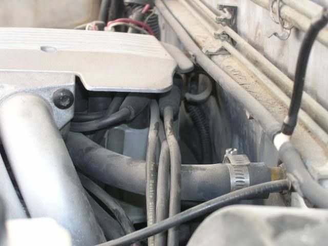

I have a TPI 350 in mine.
If you're familiar with the L98, you know that it runs a serpentine belt with a reverse rotating water pump.
There is no short pump option with the reverse rotating pump... I looked into it. So, I did mine with all long accessories.
Everyone said I was going to have to notch the firewall for the distributor, but it wasn't true.
However, I did have to move the radiator forward, so modifying the core support was in order.
But I used a '91 Firebird/Camaro radiator, so mods to the core support was inevitable.
I didn't do a build thread, but look here for more help.
