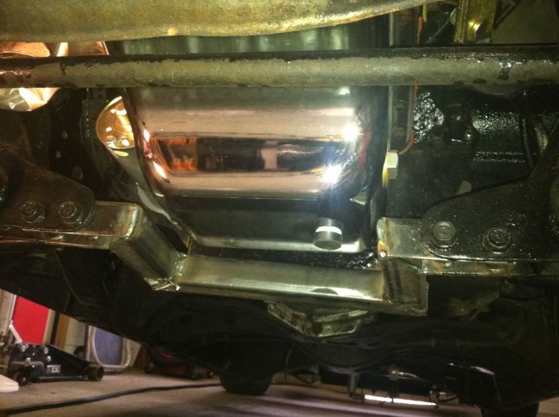

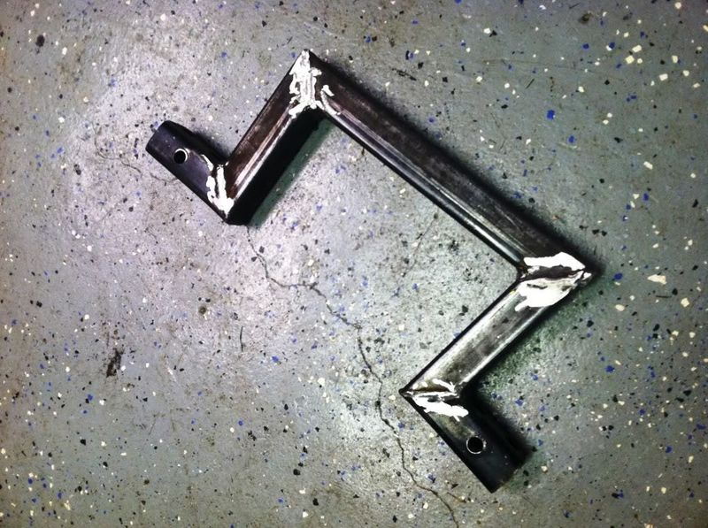

6. Yes, stang pan with rear sump. Need to modify the Xmember. This is how I did mine. Nothing fancy.
Look at my project thread for more help.
