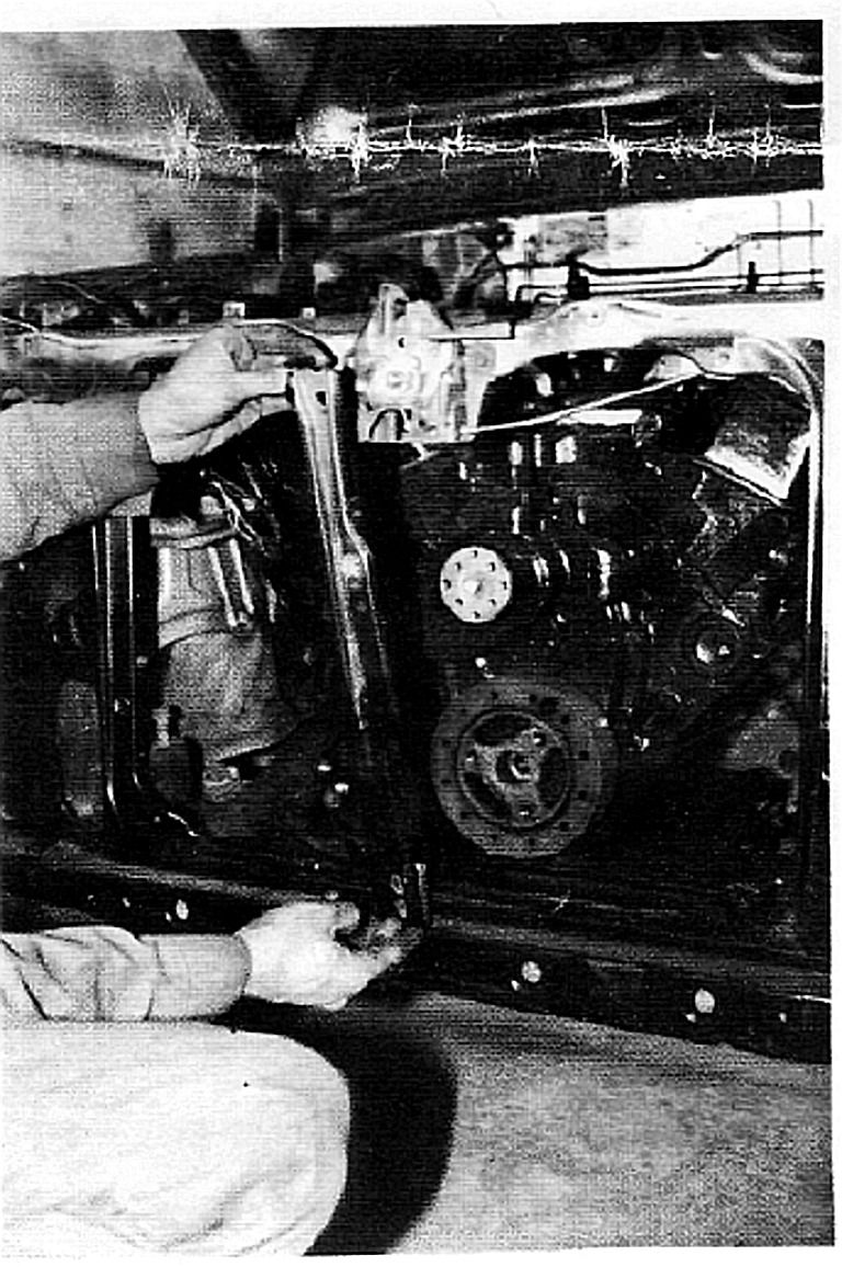

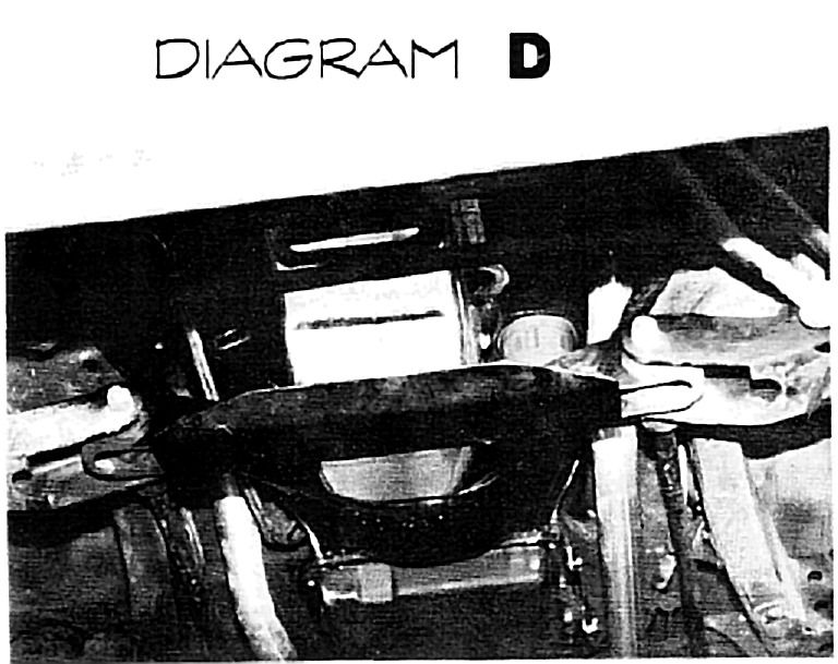

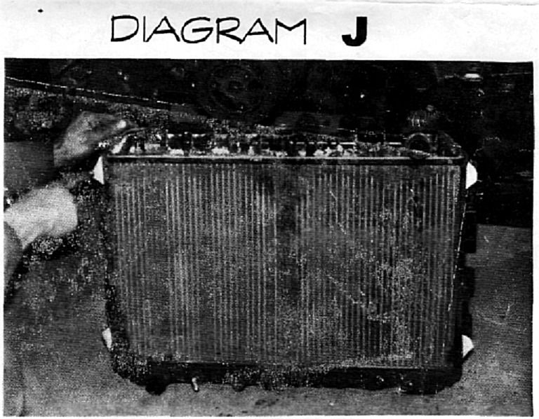

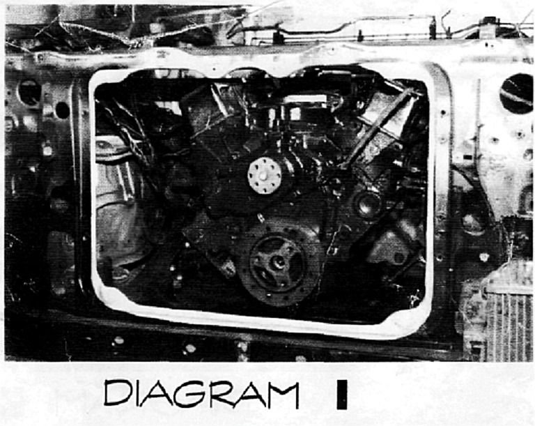

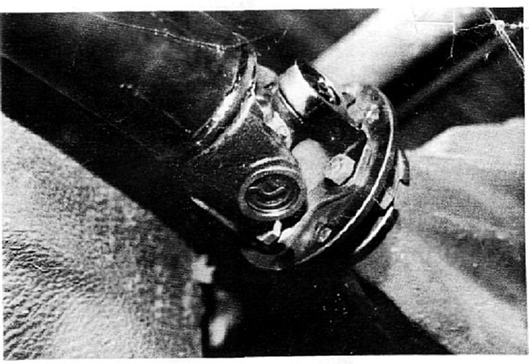

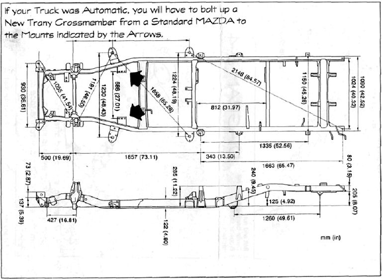

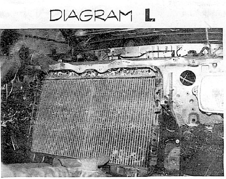

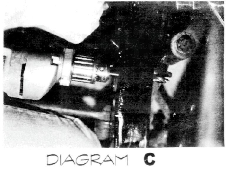

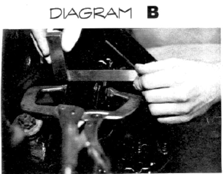

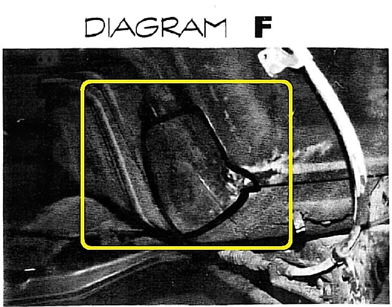

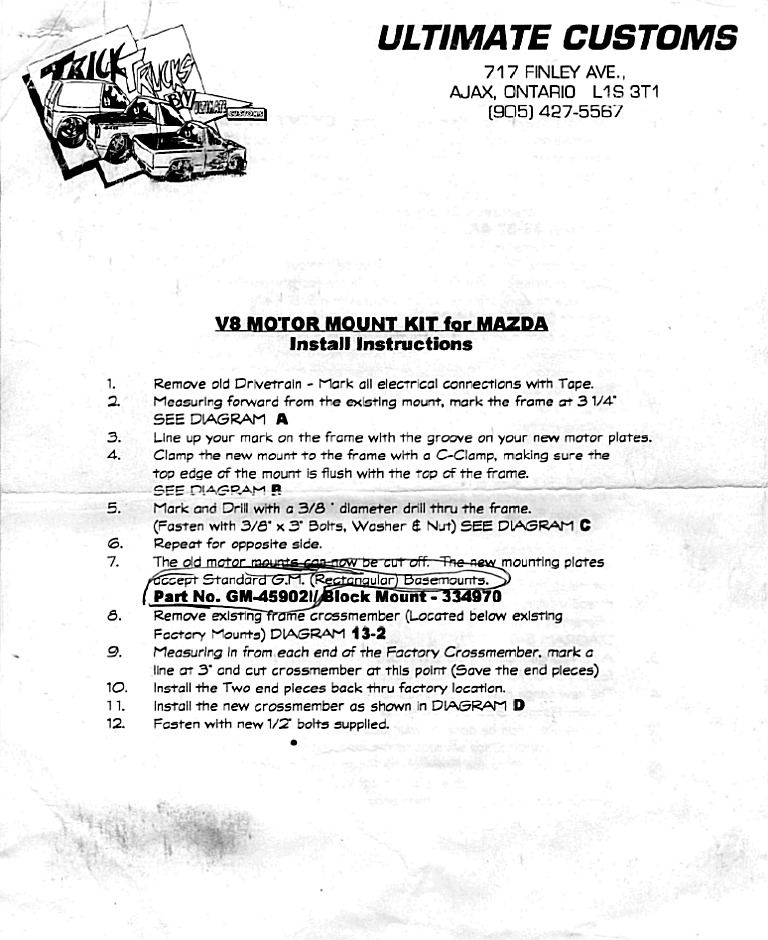

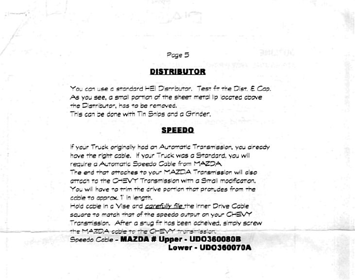

These are the instructions I got with a kit I bought back in 1996 or 97 to put a Chevy V8 into a Mazda pickup.
I know there are different ways to do it, some better... some worse than whats represented here.
I thought this would be some helpful info to some. These are snip-it files that i took from the PDF I have saved.
Some of the files are unreadable here, you can go to my photobucket and see them in a larger size.
