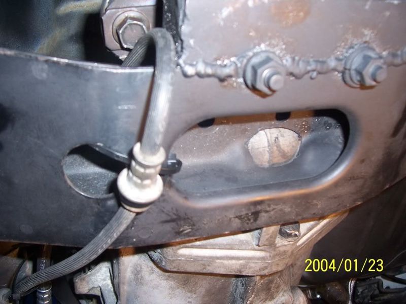

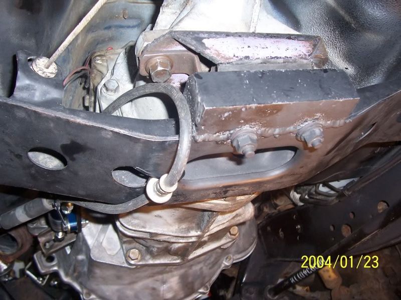

As for which 302, I don't think that there's enough differences between the different versions to cause any issues with going into your B - I'm not an expert on the differences between all the different 302's, though. Mine was from an 88 Mustang GT, and I did megasquirt EFI (which added a considerable amount of complication to the project.) There really wasn't much welding on mine - I did a little on the motor mounts just because I got the 94-95 pulley/accessory drive assembly, which gave me an extra 1.75" of room at the nose of the engine, so I moved the engine forward just a little, which meant a little welding on the motor mounts. This did, however, put the shifter (T5, 5 speed manual from a 2.3L Mustang) almost perfectly centered in the shifter hole in the cab, which saved some cutting and fabbing there. I think the only real welding was the trans mount - I needed to add a small 1.5" extension to it to mount the stock T5 trans mount. I originally did the driveshaft myself, but it was out of balance, and eventually had a pro driveline shop do it properly.

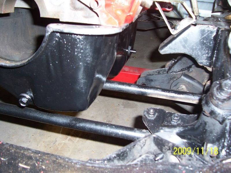

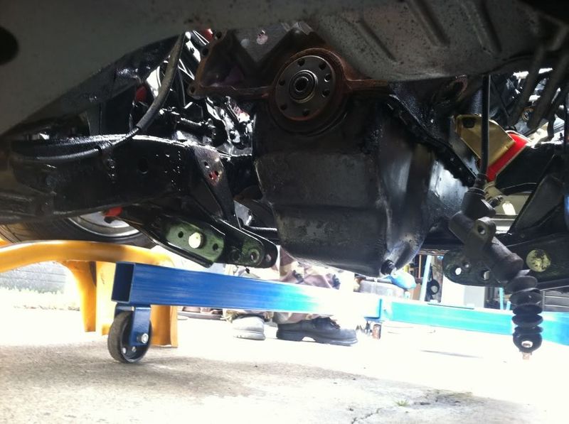

I used the stock oil pan (rear sump, with a small sump up front IIRC - I did have to chop the cross support and re-weld it, now that I think of it - missed mentioning that one above) from the 88 5.0 on mine, and it works great. As for doing a carb setup on an EFI-based engine, you will need to get an intake for a carb, since the EFI intake just isn't going to mate with the carb. They should be fairly plentiful, however. As for wiring with the carb - not much. You just need power to the starter, ground to the block, and wiring for the oil pressure sensor and coolant temp sensor - on my project, I put 3 coolant temp sensors in (one to the Megasquirt, one using the stock 2.2 sensor and a threaded adapter, to the in-dash stock temp gauge, and one to an aftermarket gauge), and 2 oil pressure sensors (one using the stock sender to the stock oil light in the dash, and one to an aftermarket gauge)

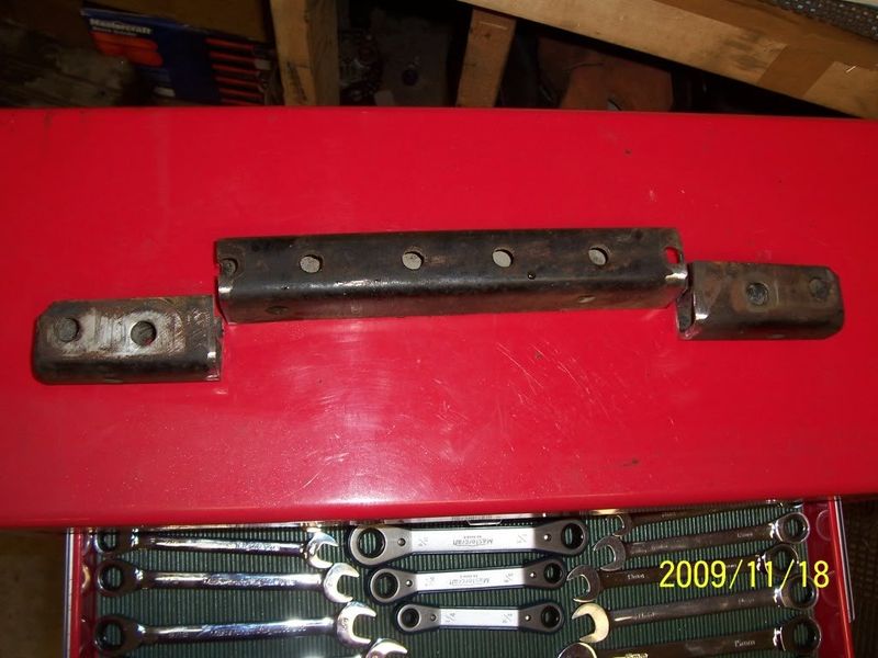

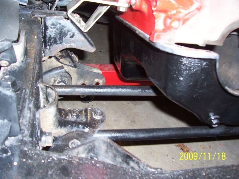

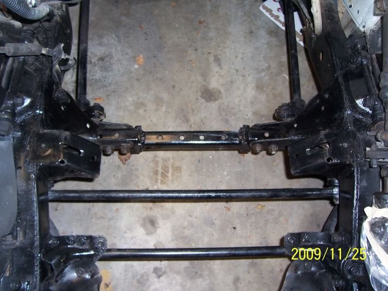

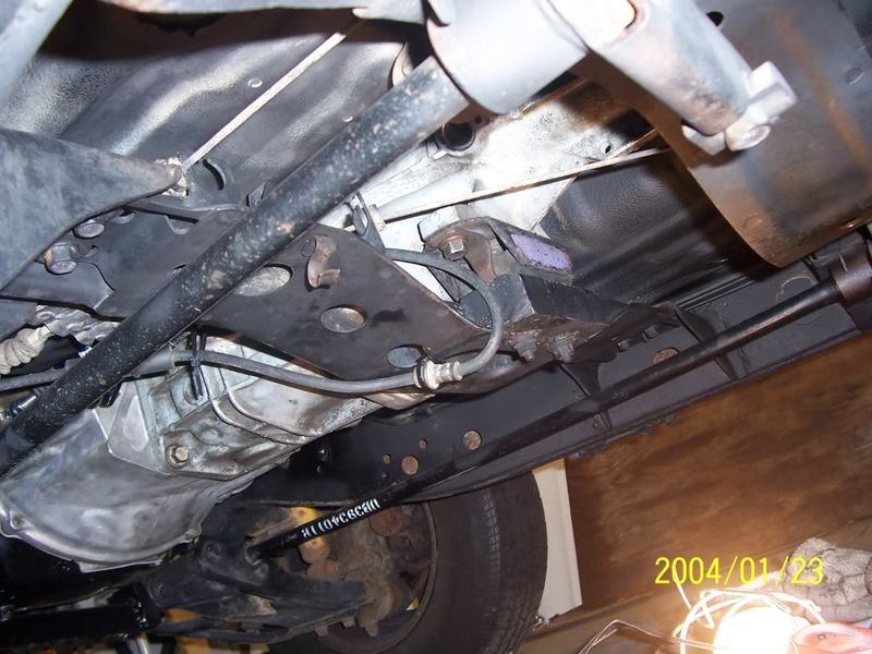

A few pics from photobucket re the different bits I had to weld:
Extension to trans support:
Oil pan stuff:
What I started with:
After:

Awesome, thanks for the pictures!
