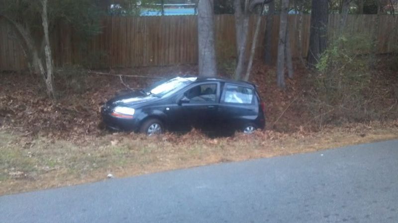

Also, this is why you shouldn't buy an Aveo
