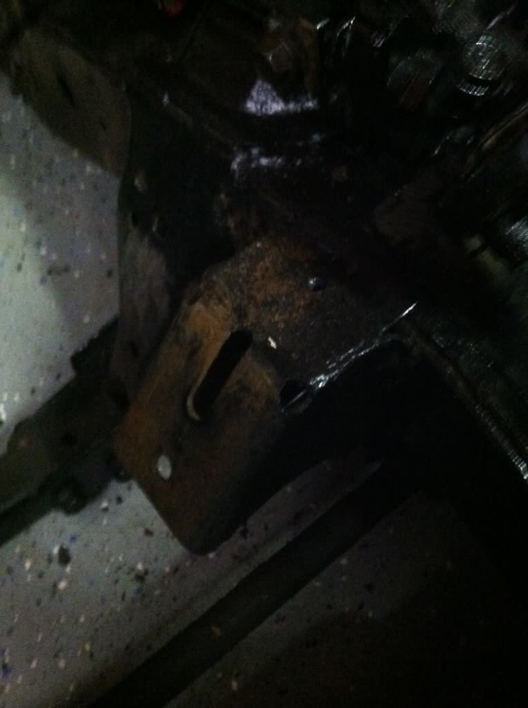

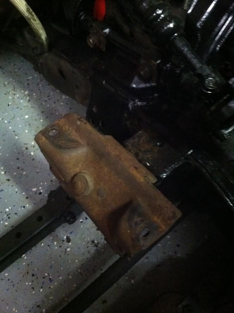

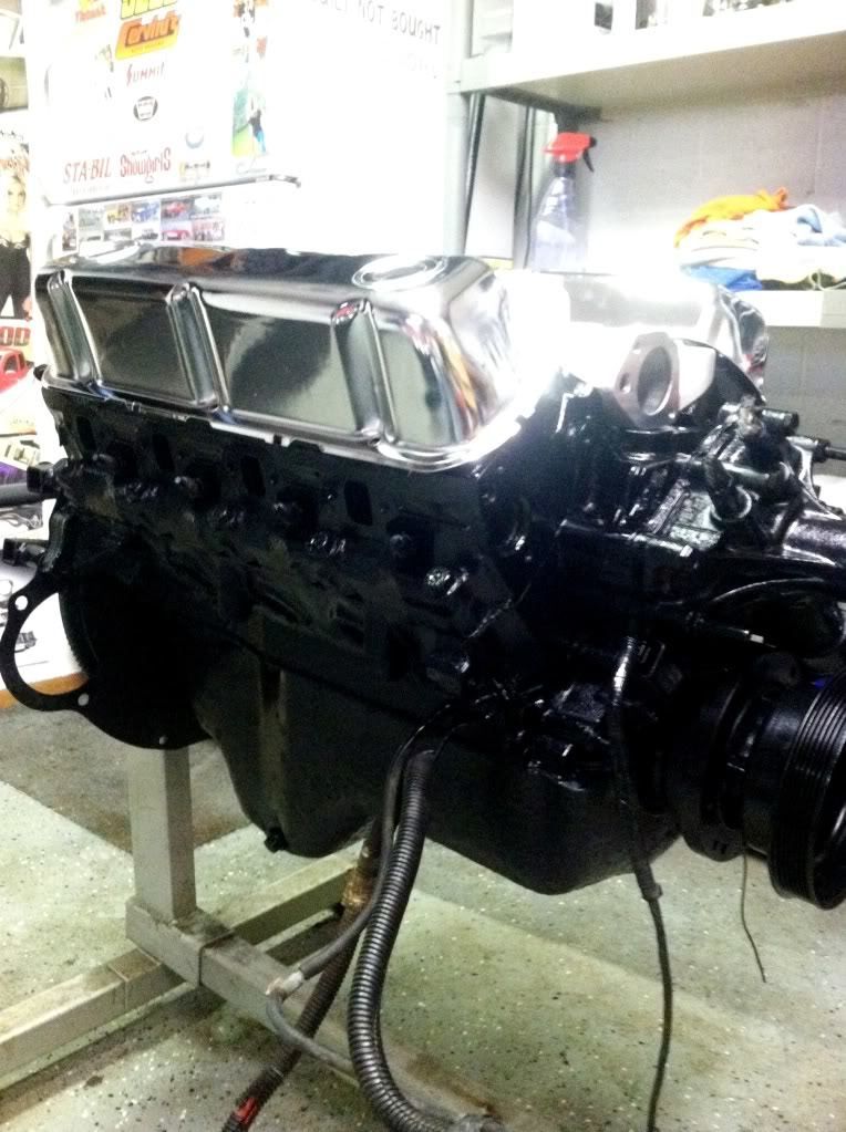

Really confused on what to do about the motor mounts for this swap. I've "read" several things on this forum saying that a 84-93 Mustange motor mounts will work, but you have to "redrill the holes bigger". No idea what that means. Because this 302 came from a 96' F-150. The motor mounts fit on the frame mounts just fine without drilling the holes bigger. Only problem is the frame mounts are 16" apart and the motor mounts on the engine block are 14" apart.
Any suggestions?
